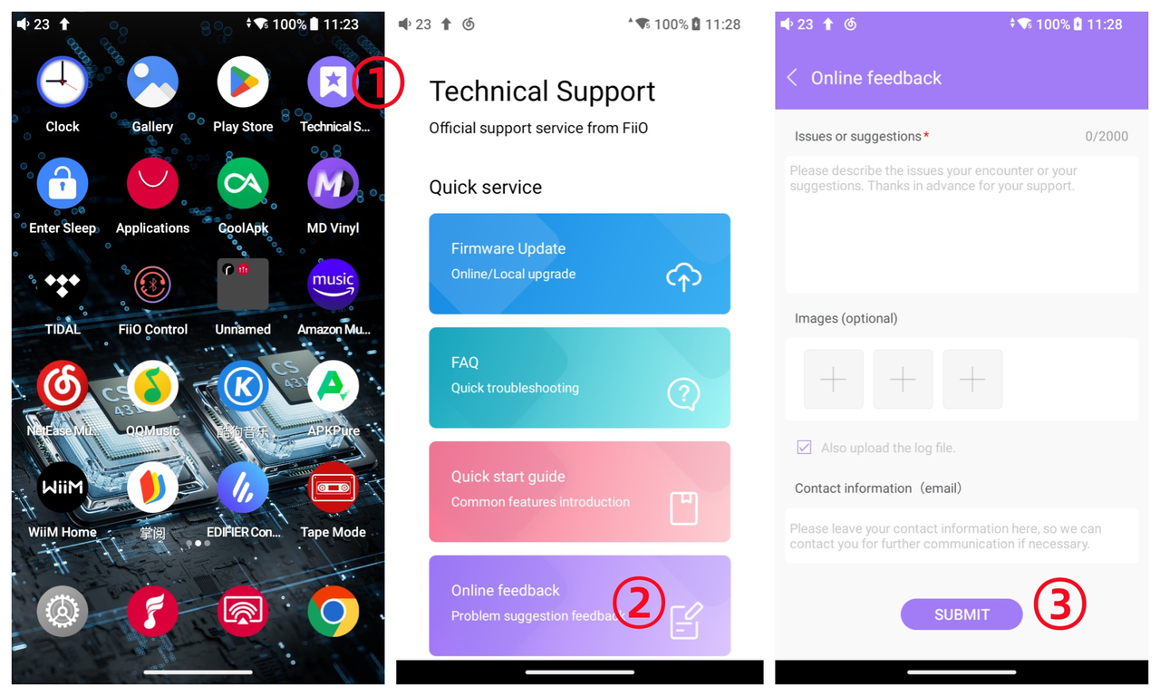

For special software issues, please extract a LOG file from the folder "fiio_log " under the root directory, zip and copy it to the homepage. Then send it to us and inform us the time of the problem for further analysis.
Or go to M33 R2R->Technical support->Online feedback to submit the problem and the log. Remember to add the happened time of the issue and a short description of the issue when uploading the log.
