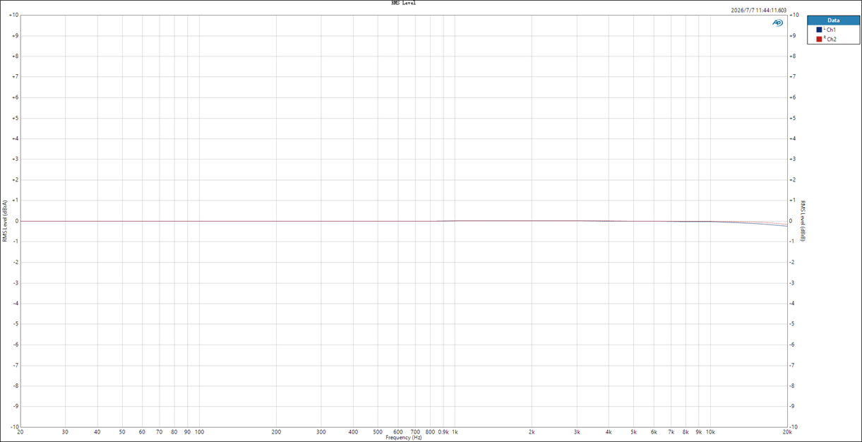

UAC, Coaxial, Optical Decoding Frequency Response Curve
Test conditions: -5dB sinusoidal signal, USB decoding/Coaxial decoding/Optical decoding, 48V/10A power supply, 20Hz–20kHz, SPK OUT (8Ω load)
Test conditions: -5dBV sinusoidal signal, LINE IN, 48V/10A power supply, 20Hz–20kHz, SPK OUT (8Ω load)
Test conditions: -5dB sinusoidal signal, USB decoding/Coaxial decoding/Optical decoding, 48V/10A power supply, 20Hz–40kHz, SPK OUT (8Ω load)
Test conditions: -5dBV sinusoidal signal, LINE IN, 48V/10A power supply, 20Hz–45kHz, SPK OUT (8Ω load)
Test conditions: -5dB sinusoidal signal, USB decoding/Coaxial decoding/Optical decoding, 48V/5A original power adapter, 20Hz–20kHz, SPK OUT (8Ω load)
Test conditions: -5dBV sinusoidal signal, LINE IN, 48V/5A original power adapter, 20Hz–20kHz, SPK OUT (8Ω load)
Test conditions: -5dB sinusoidal signal, USB decoding/Coaxial decoding/Optical decoding, 48V/5A original power adapter, 20Hz–40kHz, SPK OUT (8Ω load)
Test conditions: -5dBV sinusoidal signal, LINE IN, 48V/5A original power adapter, 20Hz–45kHz, SPK OUT (8Ω load)

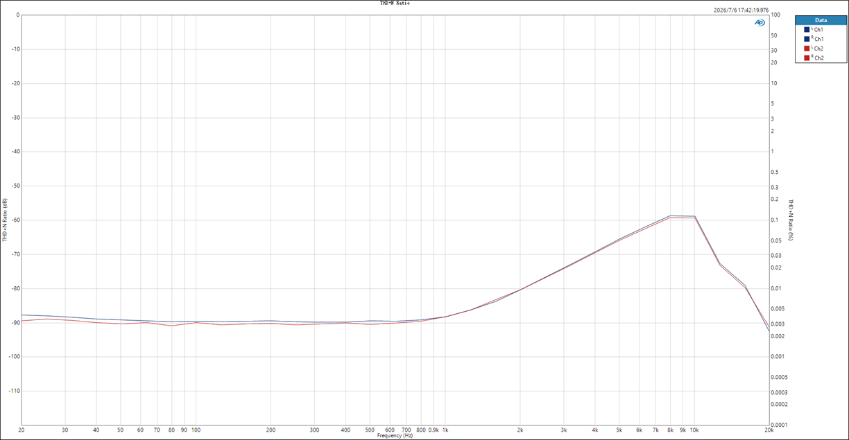

UAC, Coaxial, Optical Decoding Distortion Curve
Test conditions: -16dB sinusoidal signal, USB decoding/Coaxial decoding/Optical decoding, 48V/10A power supply, SPK OUT (4Ω load)
Test conditions: -19dBV sinusoidal signal, LINE IN, 48V/10A power supply, SPK OUT (4Ω load)
Te est con ons: - 12dB sinusoidal signal, USB decoding/Coaxial decoding/Optical decoding, 48V/5A original 1 power adapter, S SPK OUT (8Q load)

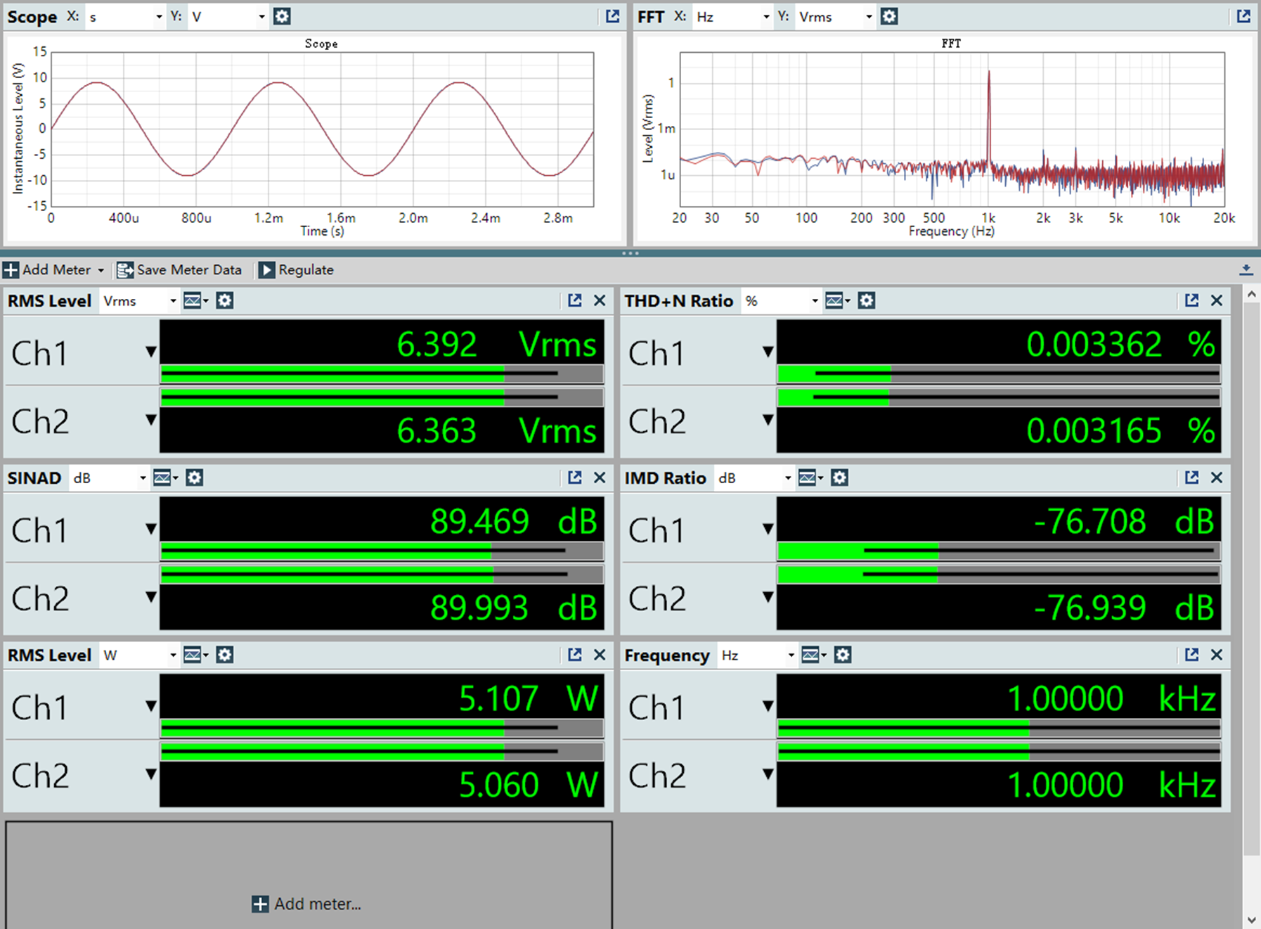

SPK OUT Output 5W@8Ω
SPK OUT Output 5W@4Ω

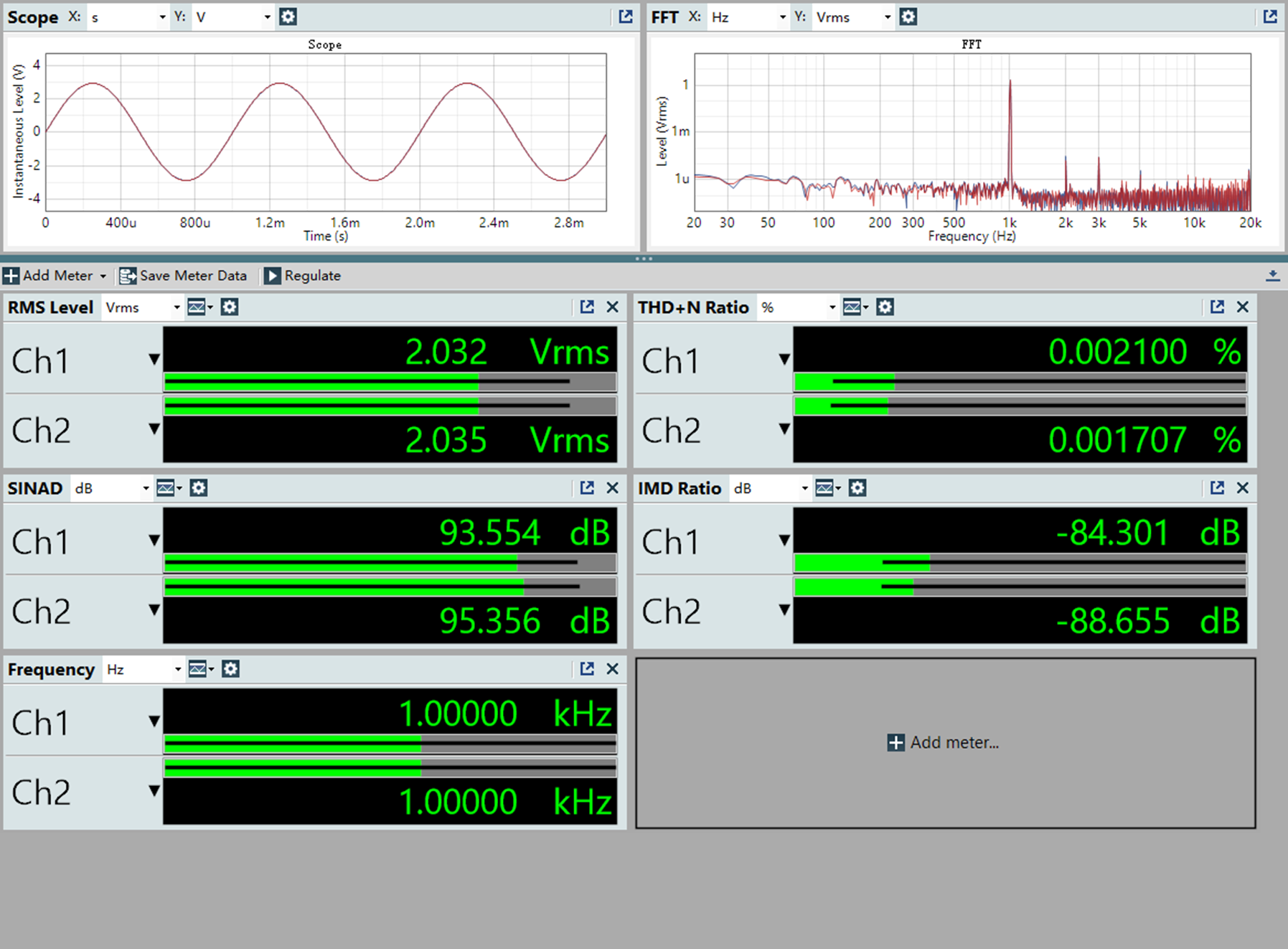

PRE OUT Output @10kΩ

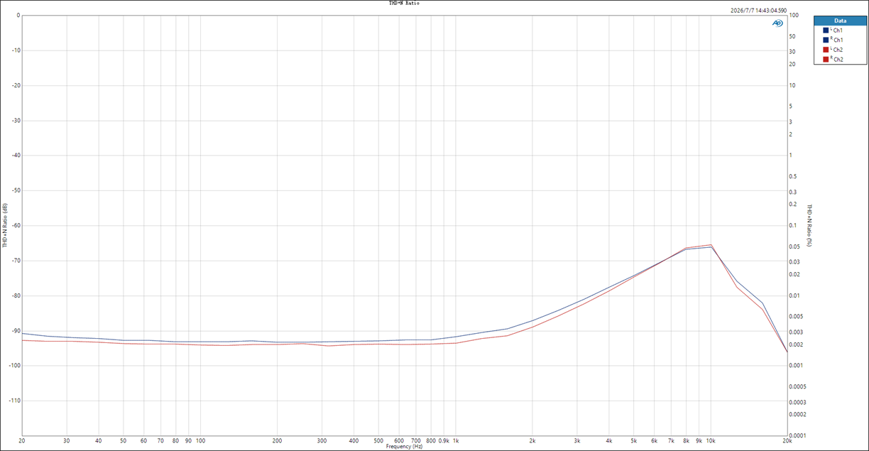

Test conditions: -16dB sinusoidal signal, USB decoding/Coaxial decoding/Optical decoding, 48V/5A original power adapter, SPK OUT (4Ω load)
Test conditions: -19dBV sinusoidal signal, LINE IN, 48V/5A original power adapter, SPK OUT (4Ω load)
Test conditions: -12dB sinusoidal signal, USB decoding/Coaxial decoding/Optical decoding, 48V/5A original power adapter, SPK OUT (8Ω load)
