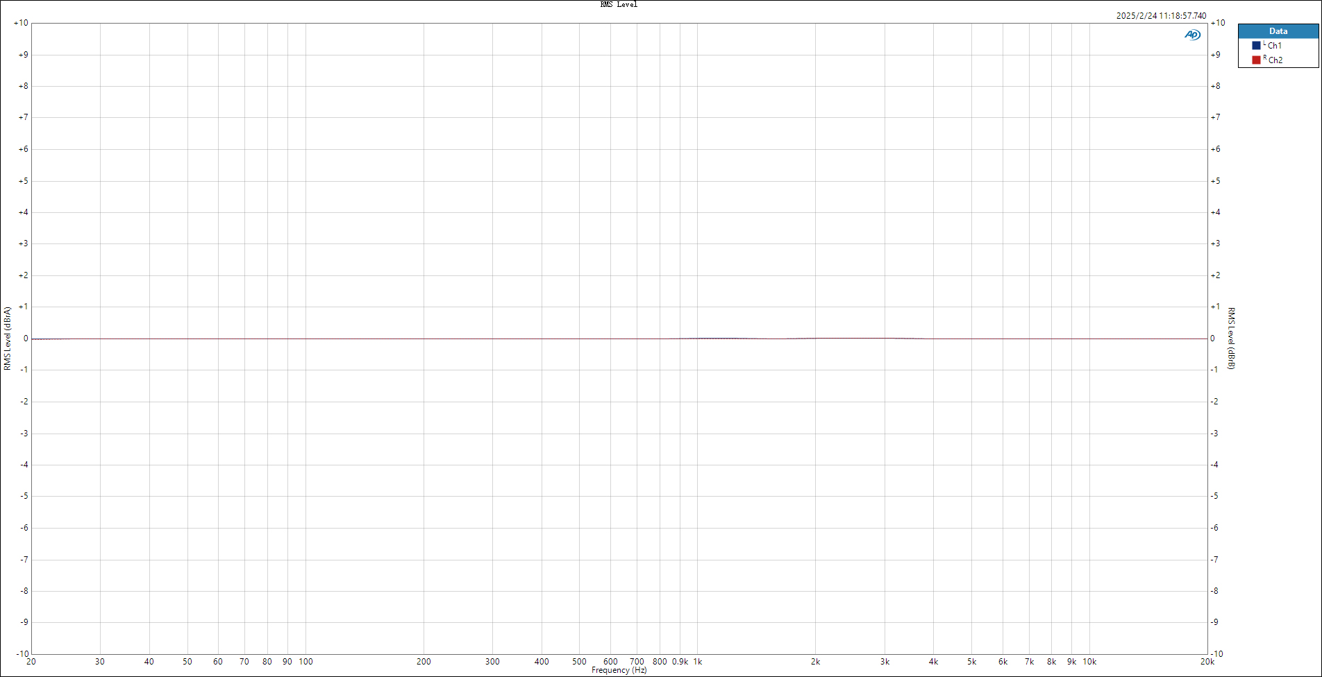

UAC, coaxial, fiber decoding frequency response curve 2
Test conditions: -5dB sinusoidal signal, 20Hz~20kHz, balanced headphone out, high gain (32Ω load)

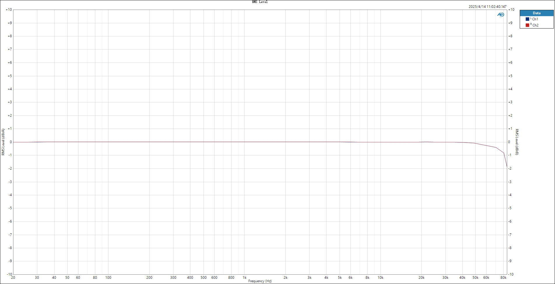

UAC Decoding Frequency Response Curve 1
Test conditions: -5dB sinusoidal signal, 20Hz-85kHz, line-out (10kΩ load)

UAC Decoding Frequency Response Curve 2
Test conditions: -5dB sinusoidal signal, 20Hz-85kHz, headphone out, high gain mode (32Ω load)
UAC Decoding Frequency Response Curve 4
Test conditions: -5dB sinusoidal signal, 20Hz-20kHz, line-out (10kΩ load)

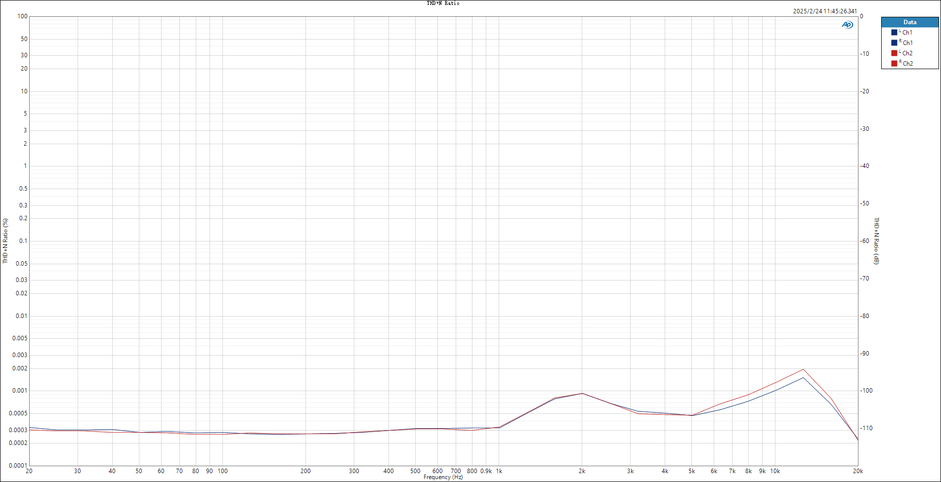

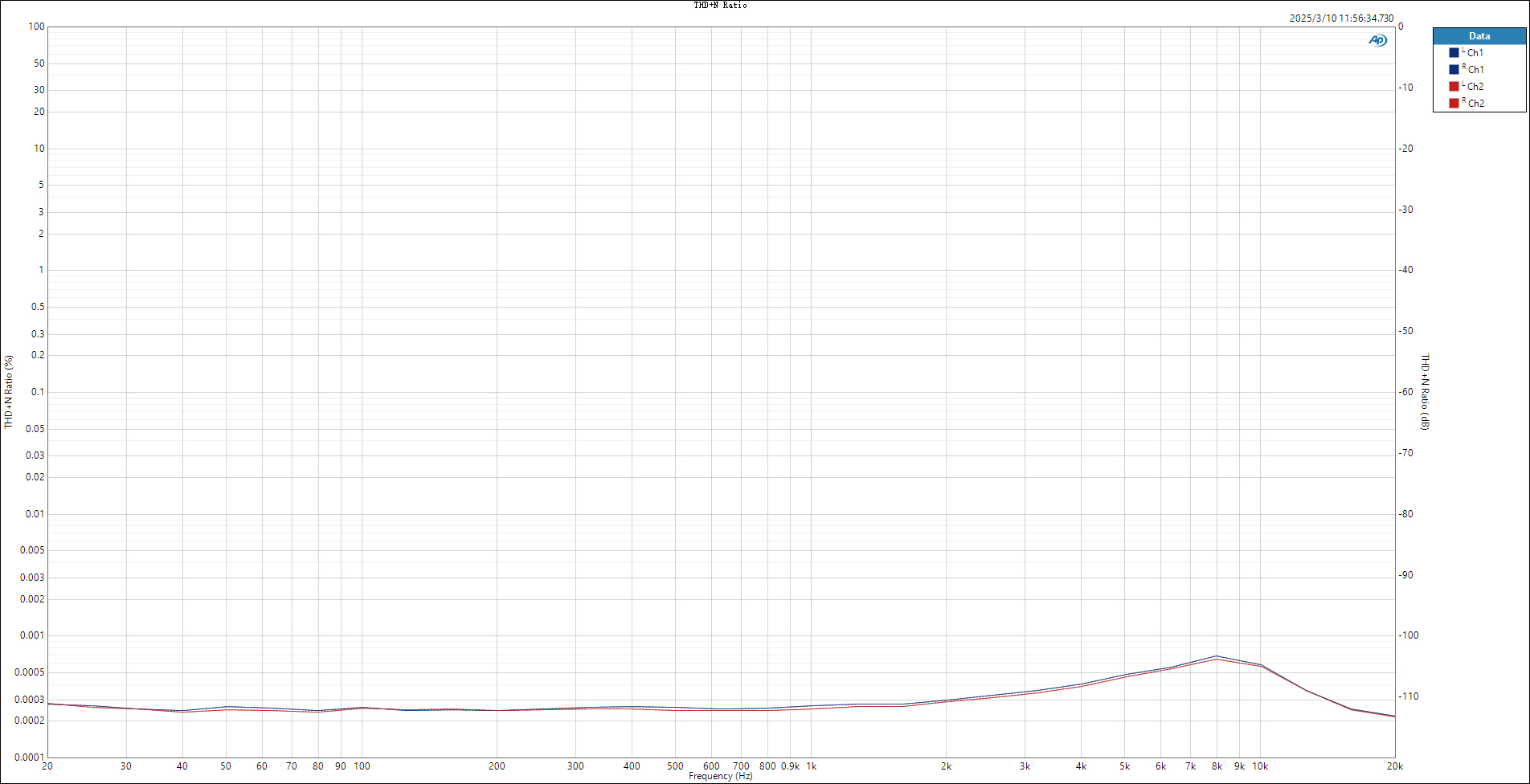

UAC Decoding Distortion Curve 1
 Test conditions: -4dB sinusoidal signal, headphone out, high gain mode (32Ω load)

UAC Decoding Distortion Curve 2
Test conditions: -4dB sinusoidal signal, headphone out, super high gain mode (32Ω load)
