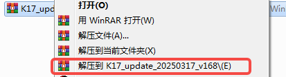

2. Select “Unzip to K17_update_20250317_Vxxx”, as shown in the following picture:
