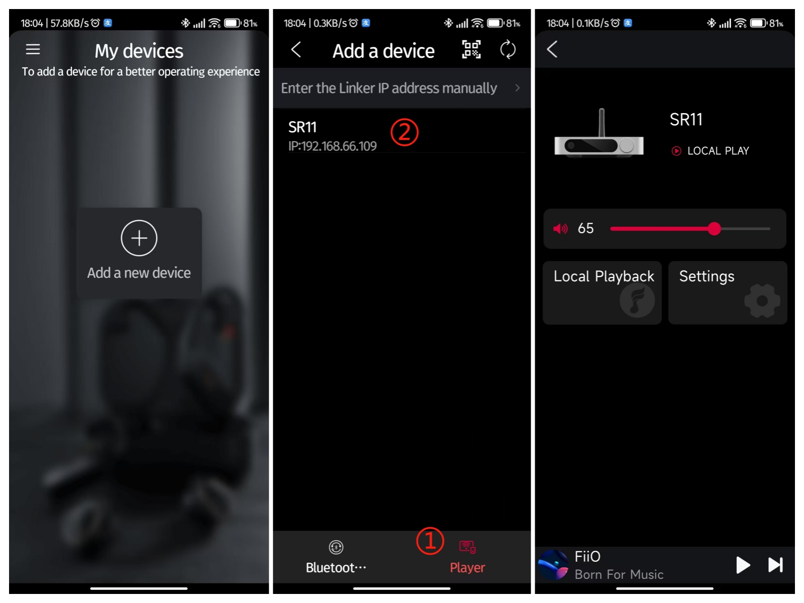

3. Make sure that SR11 has completed network configuration and connect the mobile phone, SR11 to the same network. (SR11 Network connections instruction:https://www.fiio.com/newsinfo/912282.html)
4.Install the latest version FiiO Control APP in your mobile phone.
(If a permission prompt appears for the first time, please click “Allow” to obtain the corresponding permissions.)
Go to FiiO Control APP-Add a new device-Player and you will find SR11. After successful connection, you will enter the control interface of SR11.
