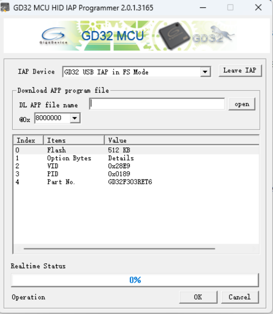

3. Open the "GD32_MCU_HID_IAP_Programmer" burning tool (this tool requires no installation). Note: The setting of "IAP Device" must be "GD32 USB IAP in FS Mode", please do not change it!

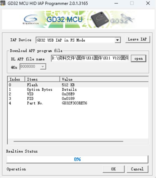

4. Click "open" and select the file "k11_app-vxxx.hex".

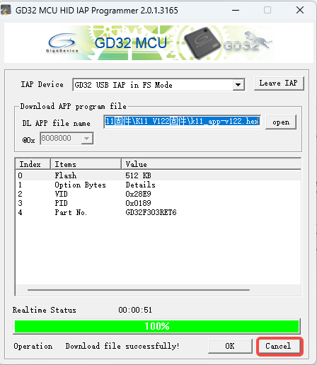

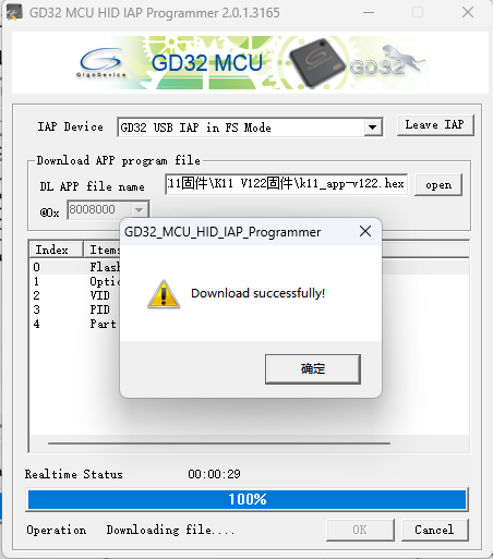

5. Click "OK" to start the firmware upgrade. After the upgrade is completed, "Download successfully!" will be displayed. Click "确定" and then "Cancel" to exit the upgrade tool.
Note: As shown in the figure below, please click the "Cancel" button in this interface to exit the software; do not click "OK", otherwise the software will re-enter the upgrade state.
