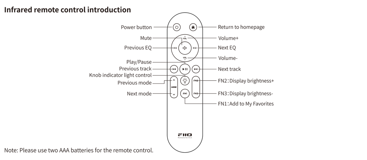

[Remote control instructions]
Difference between powering off via panel knob and entering standby mode via remote control
1.When powering off via the panel knob, there will be boot animation after restart.
2.When entering standby mode via remote control standby, no boot animation when you turn it on again and you can wake up the K15 immediately.
