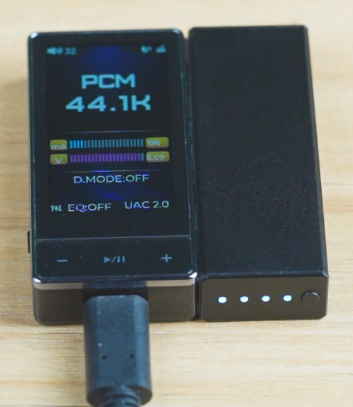

16. How to charge the mini power bank ESTICK with QX13?
1) Connect the ESTICK to the QX13. Enter the menu interface, find the Charging Settings menu, and switch it ON.
2) Connect the main USB port to a power source.
3) A pop-up window will appear asking whether to start charging. Select “Yes” to begin charging the ESTICK.
Note: When the charging setting is turned on, please do not connect power adapters to both USB ports of the QX13 simultaneously, to avoid damaging the device.
