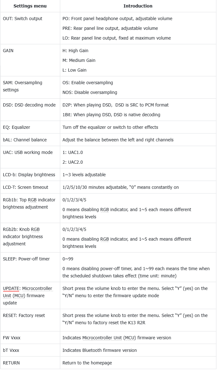

⑤Introduction to Settings menu
SAM(Oversampling settings):
The default option is OS and over sampling is on. When external audio datas transform to the K13 R2R, it will be oversampled and converted to a 384k sampling rate (in simple word: upscaling). Then the data will be sent to the R2R module for decoding. The purpose of oversampling is to change the distribution of quantization noise and improve the SNR.
When the SAM option is set to NOS, oversampling is off. The audio data will be decoded and processed in its original sampling to present the original sound experience.
DSD(DSD decoding mode):
The default option is D2P. When playing DSD format tracks, the device internally employs SRC to convert DSD to PCM before decoding via the R2R module.
When the DSD option is set to 1BIT: When playing DSD format tracks, no SRC processing is performed. Instead, DSD is 1bit DSD native decoding. (Note: When 1bit DSD native decoding is selected, the SAM: NOS/OS menu option is disabled.The software background will use NOS mode for decoding both DSD and PCM).
