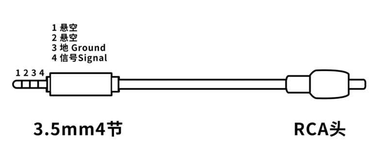

a. In this mode, the digital signal is decoded by the external DAC, and the DISC functions as a digital transport.
b. The pinout/definition of the coaxial cable is as follows:
