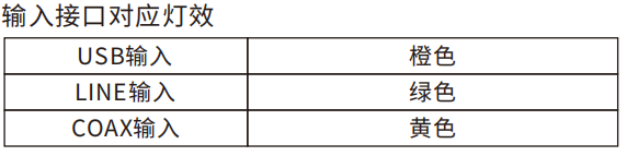

1. Switch to the corresponding input mode by short pressing the volume knob, and the corresponding indicator color is as follows:

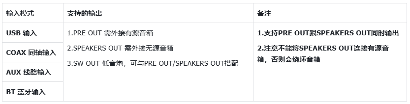

3. Play the audio source. Adjust it to the appropriate volume in LEVEL 1. The output does not need to be switched, and the corresponding output port can be connected to output.
LEVEL 1 Input Output Description
