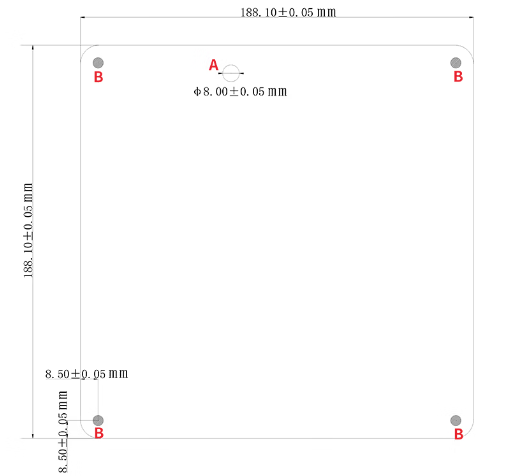

1.DIY faceplate dimensions & magnet position diagram note:
N52 round high-strength magnets are 7mm in diameter and 2mm thick. The custom DIY faceplate is recommended to be attached over the base panel.
Mark A: Infrared receiver position. Transparent ink printing is suggested here; otherwise, remote control functionality may be impaired.
Mark B: Four positions for affixing round magnets. Confirm magnet orientation and polarity before installation.
