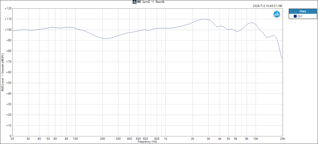

5.Frequency Response Graph
Frequency Response Range: 20Hz – 40kHz
