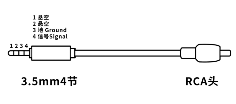

If you need to use the coaxial output function, enter the menu and turn on the coaxial output switch, then use a dedicated 3.5mm to RCA coaxial cable to connect to the input of other devices for signal transmission.
When using the 3.5mm audio output normally, it is recommended to turn off the coaxial output switch.
The supported interface definition of the 3.5mm coaxial port is as follows:
Note: The coaxial output volume cannot be adjusted. You need to use a decoder or amplifier to adjust the volume.
