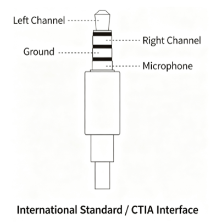

Yes, the QX11's 3.5mm headphone jack supports CTIA protocol inline remote, supports volume adjustment and play/pause control via the inline remote. The game mode supports the inline microphone.
The pin definition is shown below:
