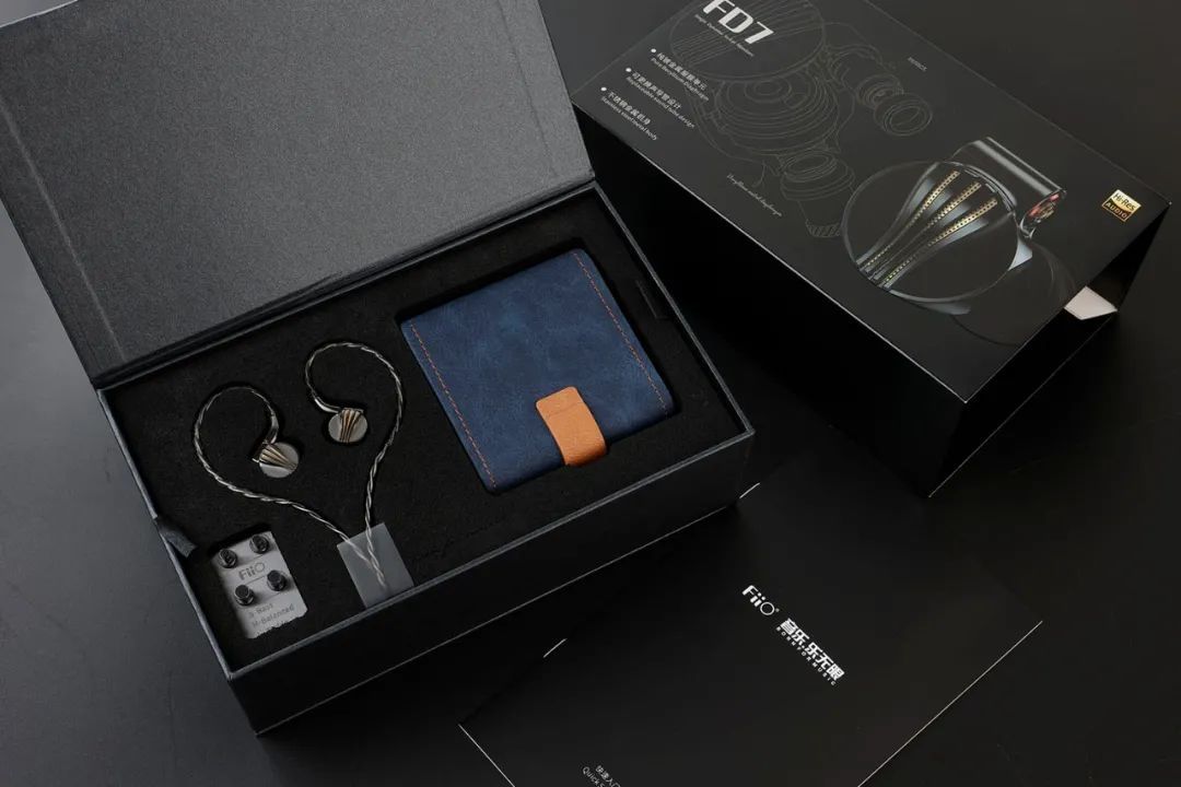

"black gold" color matching is more mysterious than one point

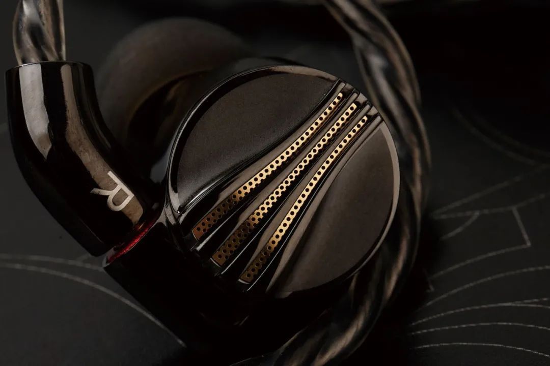

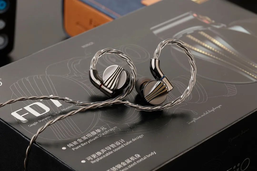

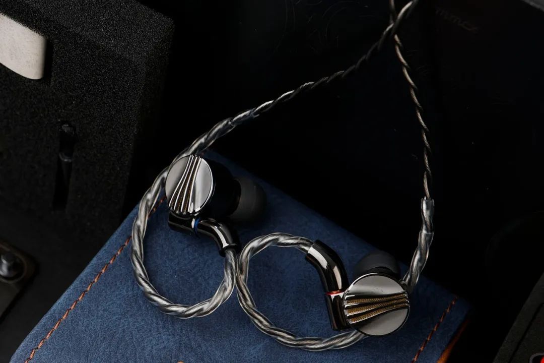

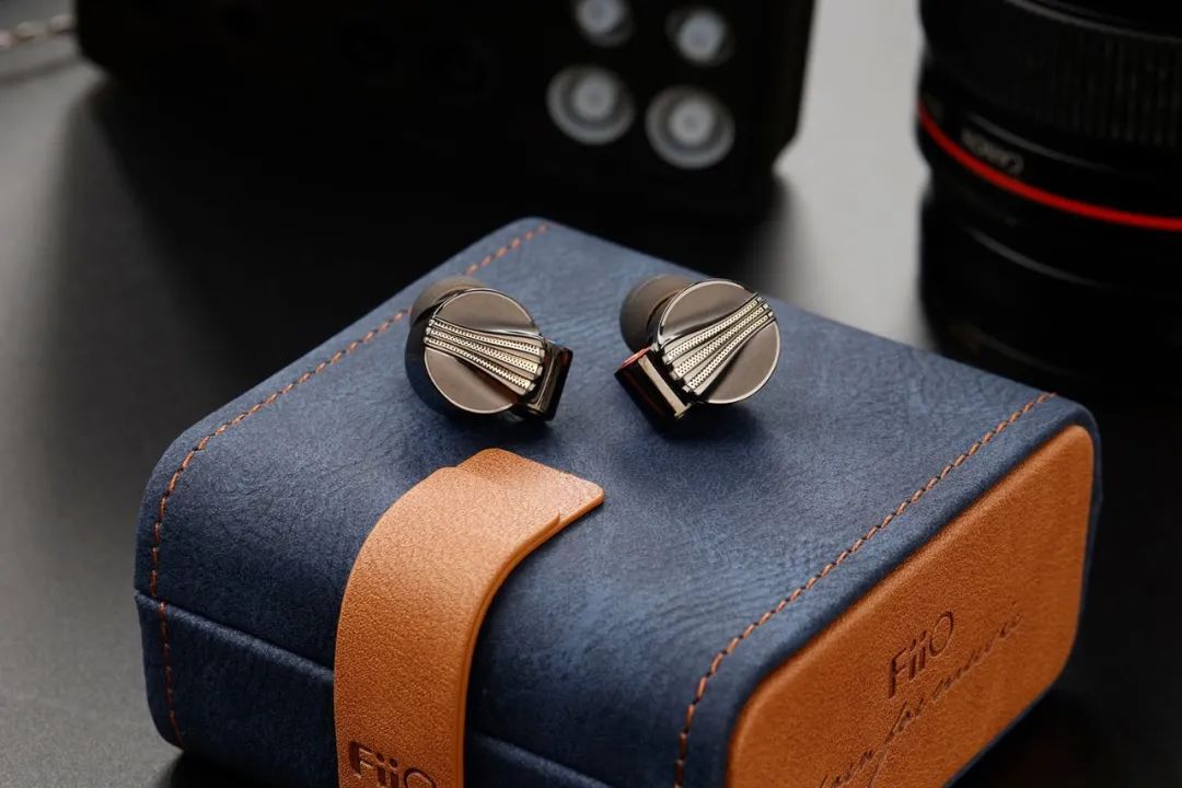

still talk about product design first. The emergence of FD7 has made FD5, which was previously the flagship of the FD series, retreat to the position of the sub-flagship, but they use the same design language-3D relief covers like mountains, rivers, waterfalls and flowing water, with a smooth and smooth cylindrical cavity. However, compared with the silver FD5,FD7 uses the exclusive color scheme of "Kurokawa Jinliu", which is more mysterious and noble. The stainless steel cavity polished by several processes shows a mirror reflection effect. After PVD coloring and hardening, the whole body is titanium crystal black.
four mirror curves with ups and downs and different widths penetrate the cover, which has a strong three-dimensional effect. The "gully" between the curves is golden, and the rest of the cover is a delicate matte coating. The "exposure and development" technology makes the collision of the two processes spark. In indoor and outdoor, under different lighting environments, the face cover and cavity of FD7 will have different visual perception, either black, calm and heavy, or shining, with strong metal texture and rich visual changes. In addition to the consideration of visual beauty, the design of the face cover also takes into account functionality.

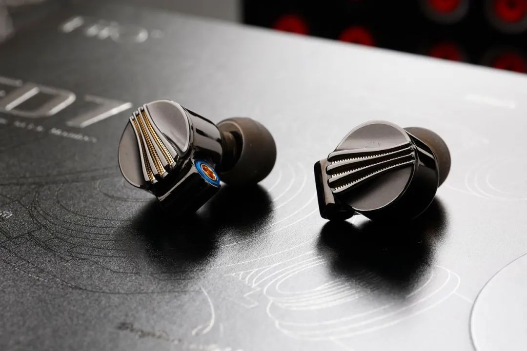

▲ The small holes in the golden area on the FD7 side are not only decorative, but also have the effect of quickly releasing pressure.
FD7 adopts a semi-open rear acoustic cavity design, with dense and regular small holes in the golden part between the curves of the cover. Their function is to quickly release the pressure, relieve the pressure of the user's ear canal, make the sound more authentic and durable, and bring the user a more comfortable listening effect.

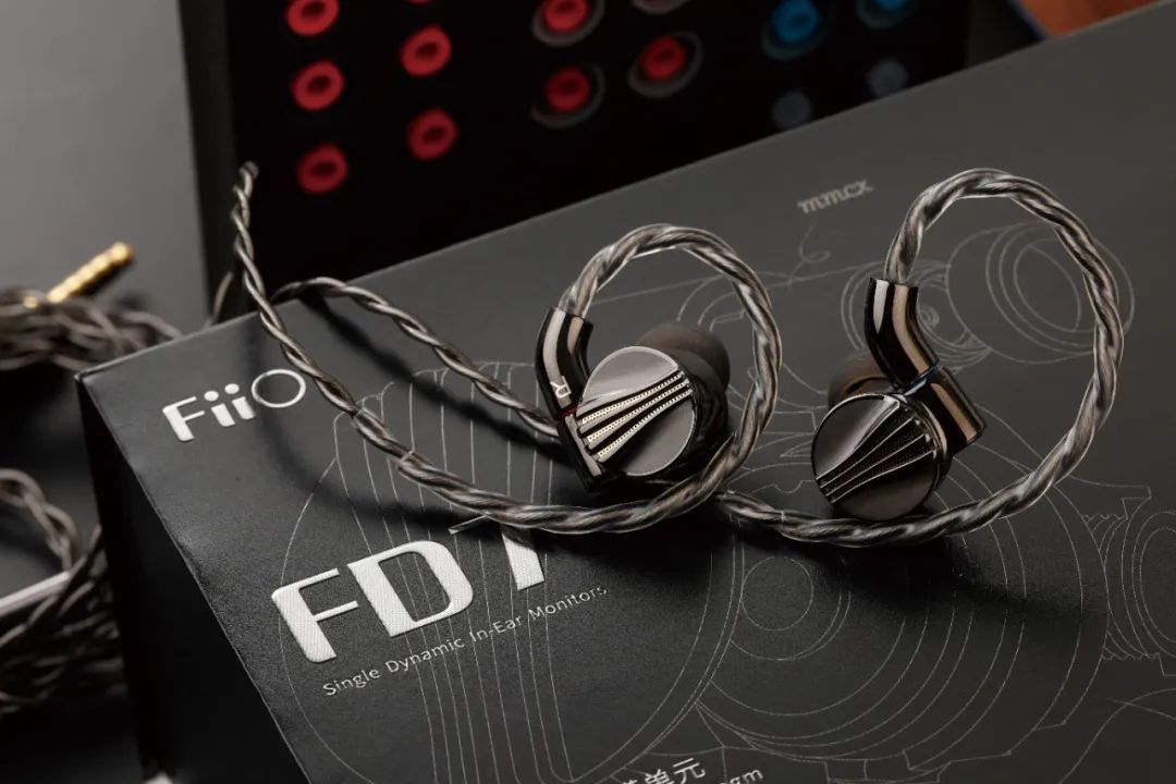

Feiao headphones has not been bad, because it likes to apply various replaceable designs to headphones. As the flagship positioning, FD7 naturally has a complete set of interchangeable designs from "head" to "tail. The first is the design of replaceable earphone cable, and the mainstream MMCX interface has strong adaptability. FD7 comes standard with a high-purity single crystal pure silver wire, which is woven by Litz, and the total number of 4 strands of wire cores is as high as 224. The wire is wrapped by imported environmental protection TPU material, which can effectively improve the yellowing of the wire body and hardening in low temperature environment after long-term use.
▲ Although the MMCX interface position of the earphone line is such a stainless steel arc treatment, it takes a lot of energy.

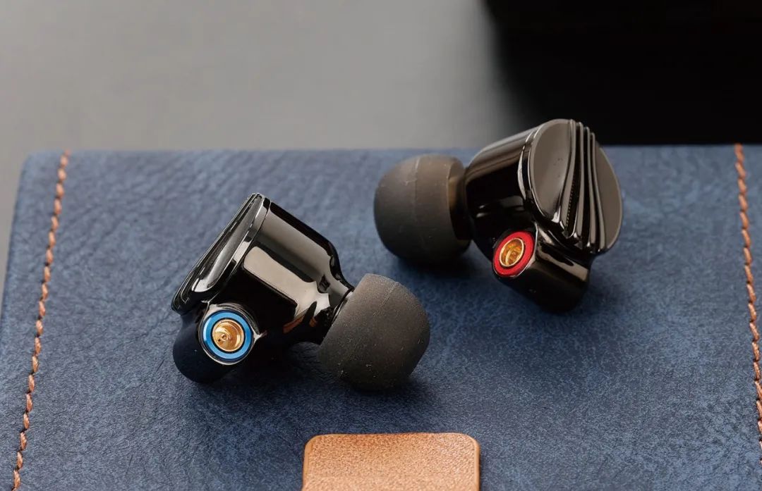

worth noting is the design of the MMCX connector part of this earphone line. Compared with the cylindrical connector of the previous earphone line, Feiao designed it into an arc shape this time, and adopted the same stainless steel material and processing technology as the earphone cavity, bringing the overall effect more uniform and beautiful. Although it is only a change of details, its actual processing difficulty is similar to that of an ear shell.

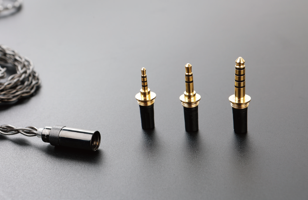

▲ FD7 adopts MMCX replaceable line design. At the same time, the plug part of the earphone line adopts in-line replaceable structure. Three plugs of 2.5mm/3.5mm/4.4mm are standard. One line meets the needs of different equipment of users.

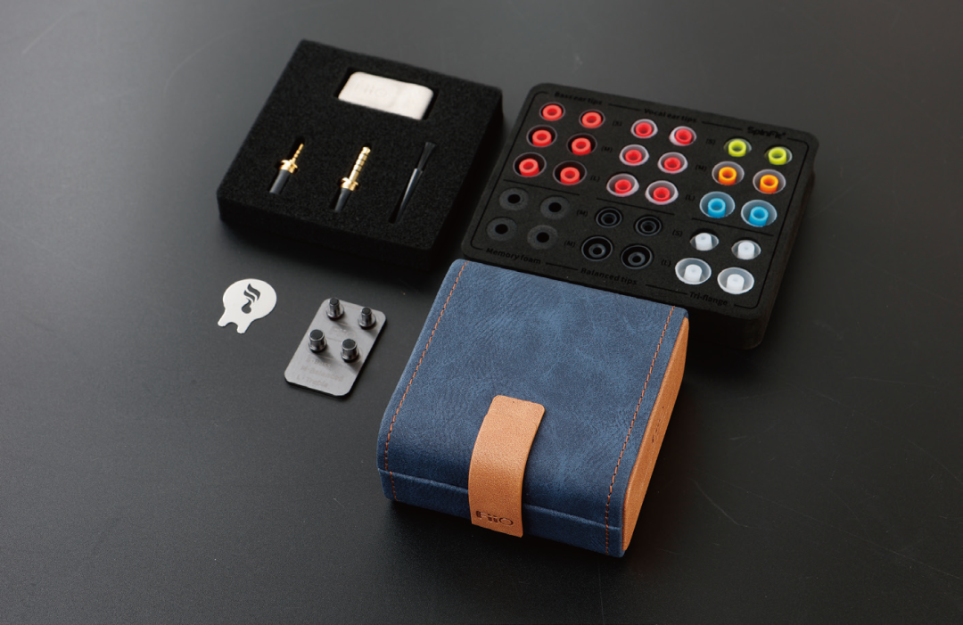

wire plug adopts in-line replaceable structure design, and comes standard with complete 2.5mm/3.5mm/4.4mm three plugs at one time. For most users, even if they do not purchase additional earphone wires, the standard earphone wires can also meet the needs of accessing various equipment.

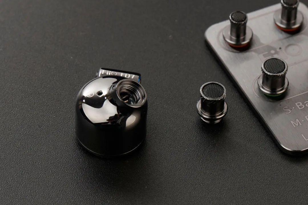

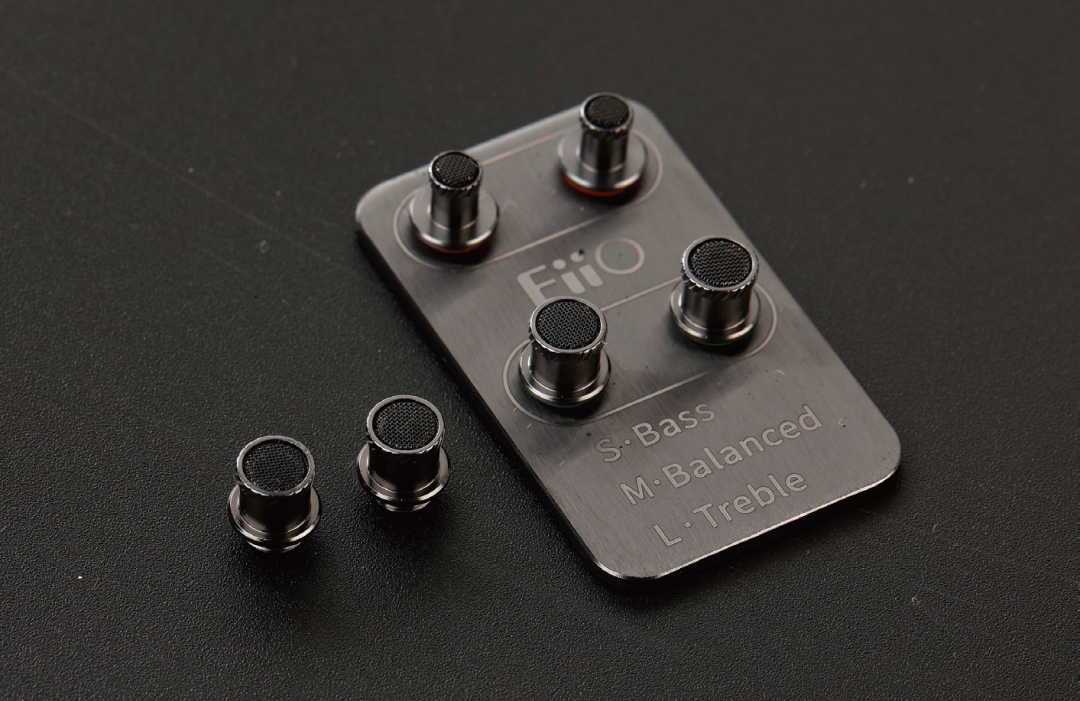

▲ FD7 has a design of interchangeable sound conduits. Three pairs of interchangeable sound conduits are equipped with standard sound styles corresponding to low-frequency dynamic, balanced tuning, and high-frequency resolution.
In addition to the change of the earphone cable plug, FD7 itself also has a replaceable sound catheter design. It comes standard with 3 pairs of interchangeable sound ducts, which correspond to low-frequency dynamic, balanced tuning, and high-frequency analytical sound styles. Compared with FD5, there are more pairs of high-frequency sound ducts. The principle is to strengthen different audio areas by adjusting the inner diameter size of the acoustic duct. It can be said that the FD7 "head" to "tail" are interchangeable design, which not only makes it more applicable, but also increases the variability of sound.
▲ FD7 has a wealth of accessories.
in terms of accessories, FD7 is richer than FD5, after all, the positioning is also higher. The main difference lies in the matching earplug sleeves. FD5 provides 13 pairs, including 3 pairs of low-frequency sleeves, 3 pairs of balanced sleeves, 3 pairs of vocal sleeves, 2 pairs of three-section sleeves and 2 pairs of sponge sleeves, while FD7 is increased to 16 pairs, with 3 pairs of SpinFit earplug sleeves as standard.

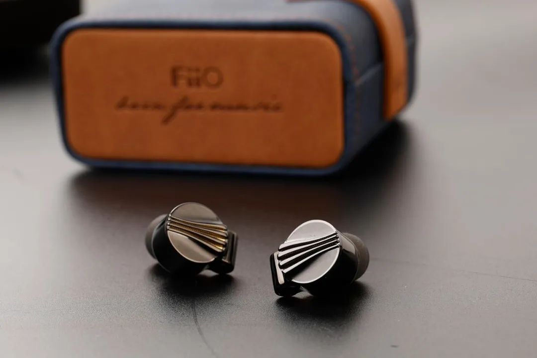

HB5 storage box, which is sold in 99 yuan on e-commerce, is also standard for FD7. The texture of the compressed leather is naturally textured, and the wiring is regular. The FiiO nameplate is a finishing touch design, and the overall grade feels good. I like its yellow and blue color matching very much, which is eye-catching and not gaudy. Magnetic belt buckle, opening and closing feel very good. The crystal super-soft fabric and velvet lining inside, together with detachable spacers, can not only better protect the earphones placed in them, but also flexibly combine the placement positions of various items. In addition, practical accessories such as MMCX quick-release aids, cleaning brushes, and magnetic wire clips are also part of FD7 accessories.

When replacing the plug of the standard earphone cable, you only need to rotate the female end to separate from the male end, and then hold the male end and pull it out. However, due to the smooth surface of the plug, it is more difficult to directly pull out the male end by hand. You can wrap the plug with flannel and then pull it out, which will be much easier. Before replacing other plugs, find the bump on the inner side of the female end, which is used to assist in positioning. At this time, align it with the groove on the male end and push it in, then rotate the female end and tighten it, and the plug will be replaced. Due to the fool-proof design of bumps, users do not have to worry about misinsertion.
The acoustic duct of FD7 is fixed or disassembled by screwing, which is convenient to replace. The three different styles of acoustic ducts it comes standard with are marked by green, black and red coil colors in addition to size distinction. At ordinary times, there are also corresponding functional marks on the metal base where idle acoustic ducts are placed. The wearing experience of FD7 is comfortable, and the default acoustic catheter and silicone sleeve can have good comfort. The round back cavity of the earphone is tightly combined with the ear cavity, and the silicone sleeve is filled in the ear canal with moderate pressure. After wearing it, you can feel a good passive noise reduction effect, but because it is a semi-open design, this pressure will not increase when listening to music, and it is suitable for longer use. At the same time, the arc-shaped design of the earphone wire connector part can better fit the ears, with delicate touch and both beauty and practicability.
