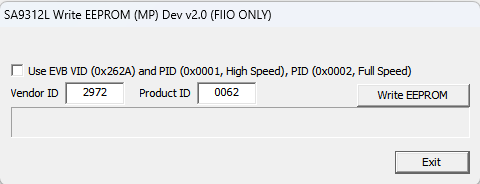

3. Double-click "FIIO_FIIO KA13_V0.15" to open the burning tool and modify the corresponding Vendor ID and Product ID. The Vendor ID is 2972 and the Product ID is 0062.
4. Click "Write EEPROM" to burn the firmware. When the following pop-up window appears, re-plug and unplug the USB interface of KA13 (power on again), and then click "确定".
