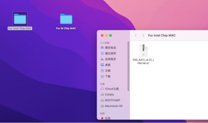

1) If you are using a MAC computer, please choose different firmware update tools according to the chip used by the computer:
2) Intel chip: Please select the firmware update tool under the KA17 firmware update tool (For MAC)\For Intel Chip MAC
3) M chip: Please select the firmware update tool under the KA17 firmware update tool (For MAC)\For M Chip MAC.

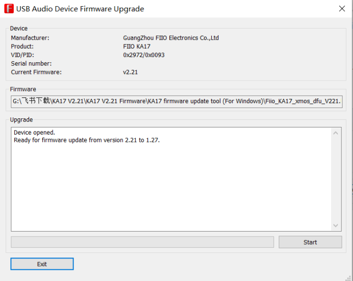

1. Double-click "FiiO_Dfu_KA17" to open the burning tool, and then click Start to upgrade.
2. When "Firmware upgrade finished successfully" appears, please re-plug KA17.At this time, the screen of KA17 will display “Updating, about 3 mins, PLS don’t unplug USB". Please wait patiently for the upgrade to complete. When the upgrade is completed, the words "UPDATE OK" will appear on the screen, indicating that the KA17 firmware upgrade is successful.

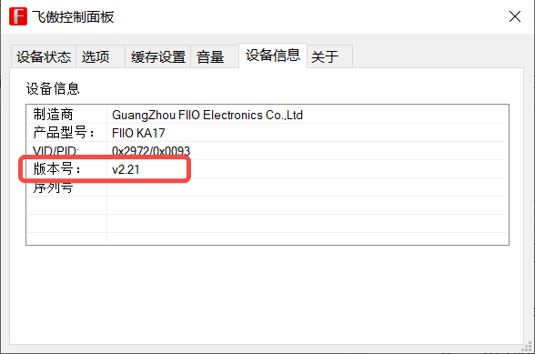

3. After the firmware upgrade is successful, you can re-plug KA17. Then you can see that the version number is displayed as xxx in the KA17 menu, and the version number is also displayed as xxx on the FiiO control panel.

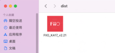

1. Double click ‘For M chip MAC’/’For Intel chip MAC’to unzip the package. Then unzip the ‘FIIO_KA17_v2.21’package.
2. Run the ‘FIIO_KA17_v2.21’

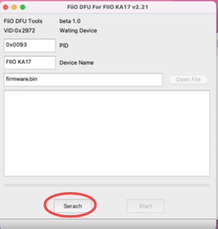

3. Click ‘Search’

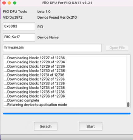

4. After detecting the KA17, click Start
5.When "Download complete" appears, you can re-plug the KA17 . At this time, the screen of KA17 will display "Updating, about 3 mins, PLS don’t unplug USB", please wait patiently for the upgrade to complete. When the upgrade is completed, the words "UPDATE OK" will appear on the screen, indicating that the KA17 firmware upgrade is successful.
