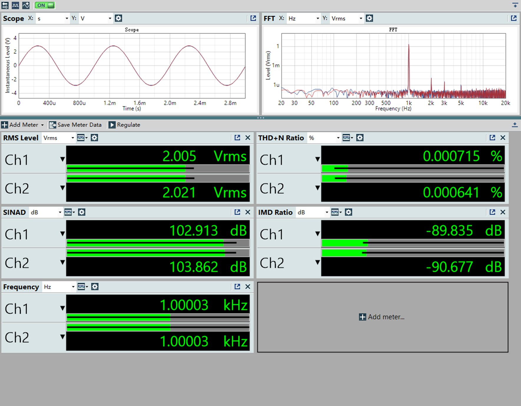

Performance and parameters of headphone output (3.5mm output, USB DAC, High gain)
Output power L+R≥135mW+135mW (16Ω, THD+N<1%, 1.5Vrms) Output impedance <0.4Ω (32Ω)
L+R≥125mW+125mW (32Ω, THD+N<1%, , 2.0Vrms) Crosstalk ≥73dB
L+R≥15mW+15mW (300Ω, THD+N<1%, 2.0Vrms) Peak output voltage 5.8Vp-p
SNR ≥117dB (A-weighted) THD+N <0.0008% (1kHz/-6dB@32Ω)
Frequency response 20Hz~80kHz: attenuation<2.4dB Noise floor <2.9uV (A-weighted)
20Hz~20KHz: attenuation<0.1dB Dynamic range ≥117dB (A-weighted)

PO High Gain 1.9V@32Ω
PO Low Gain 1V@32Ω
BAL PO Low Gain 2V@32Ω
Test conditions:

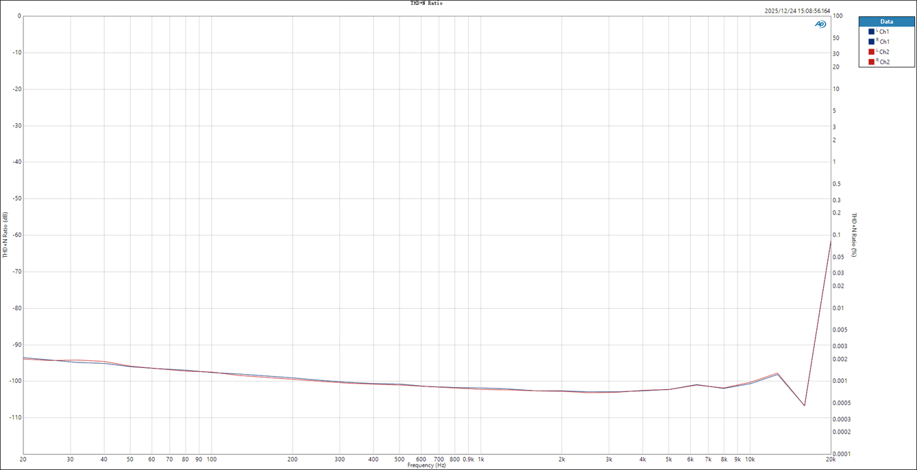

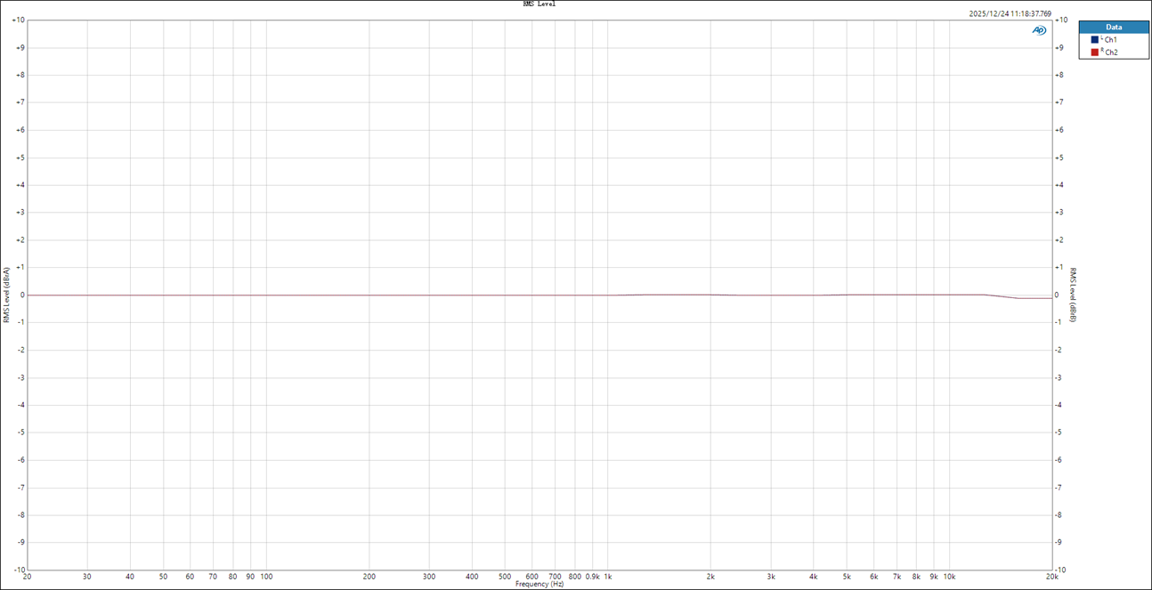

-5dB sinusoidal signal, 20Hz-20kHz, headphone out High gain (32Ω load)
Test conditions:

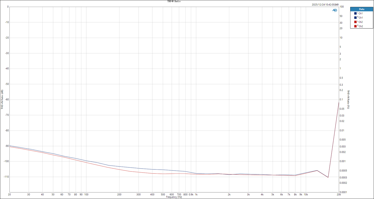

-5dB sinusoidal signal, 20Hz-20kHz, headphone out Low gain (32Ω load)
Test conditions:
-5dB sinusoidal signal, 20Hz-20kHz, balanced headphone out High gain (32Ω load)
Test conditions:
Test conditions:

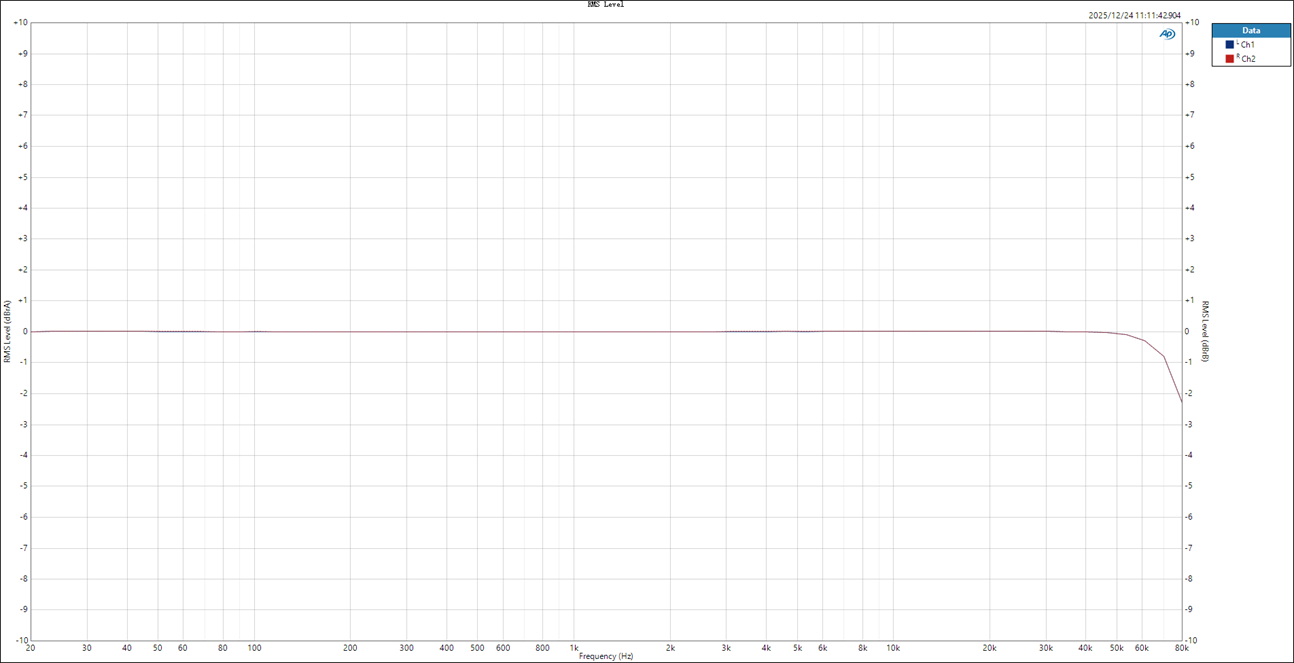

-5dB sinusoidal signal, 20Hz-80kHz, headphone out Low gain (32Ω load)
Test conditions:
-5dB sinusoidal signal, 20Hz-80kHz, balanced headphone out High gain (32Ω load)
Test conditions:

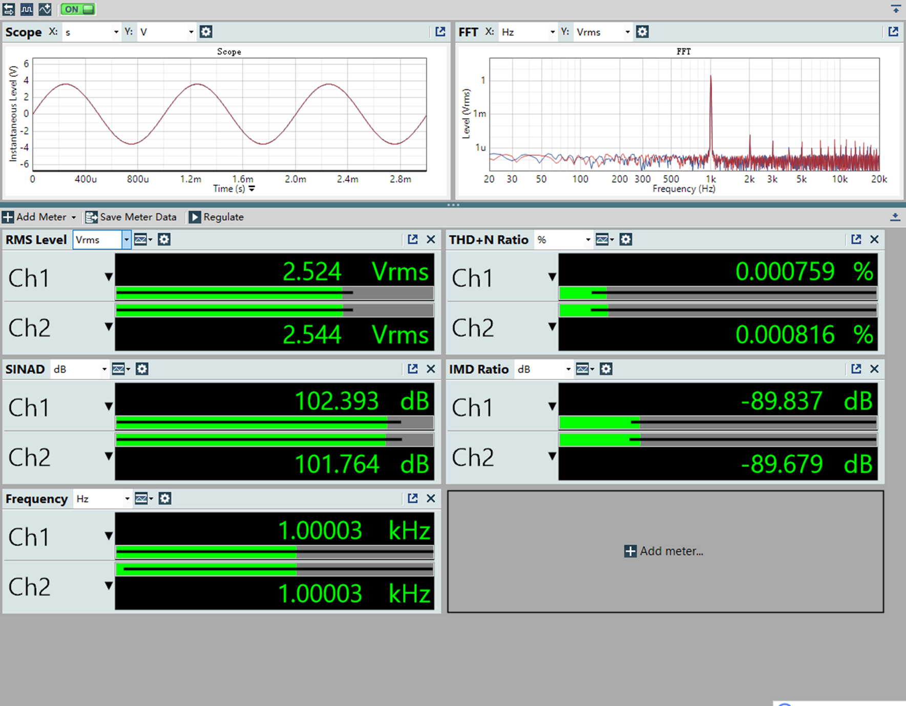

-6dB sinusoidal signal, headphone out High gain (32Ω load)
Test conditions:

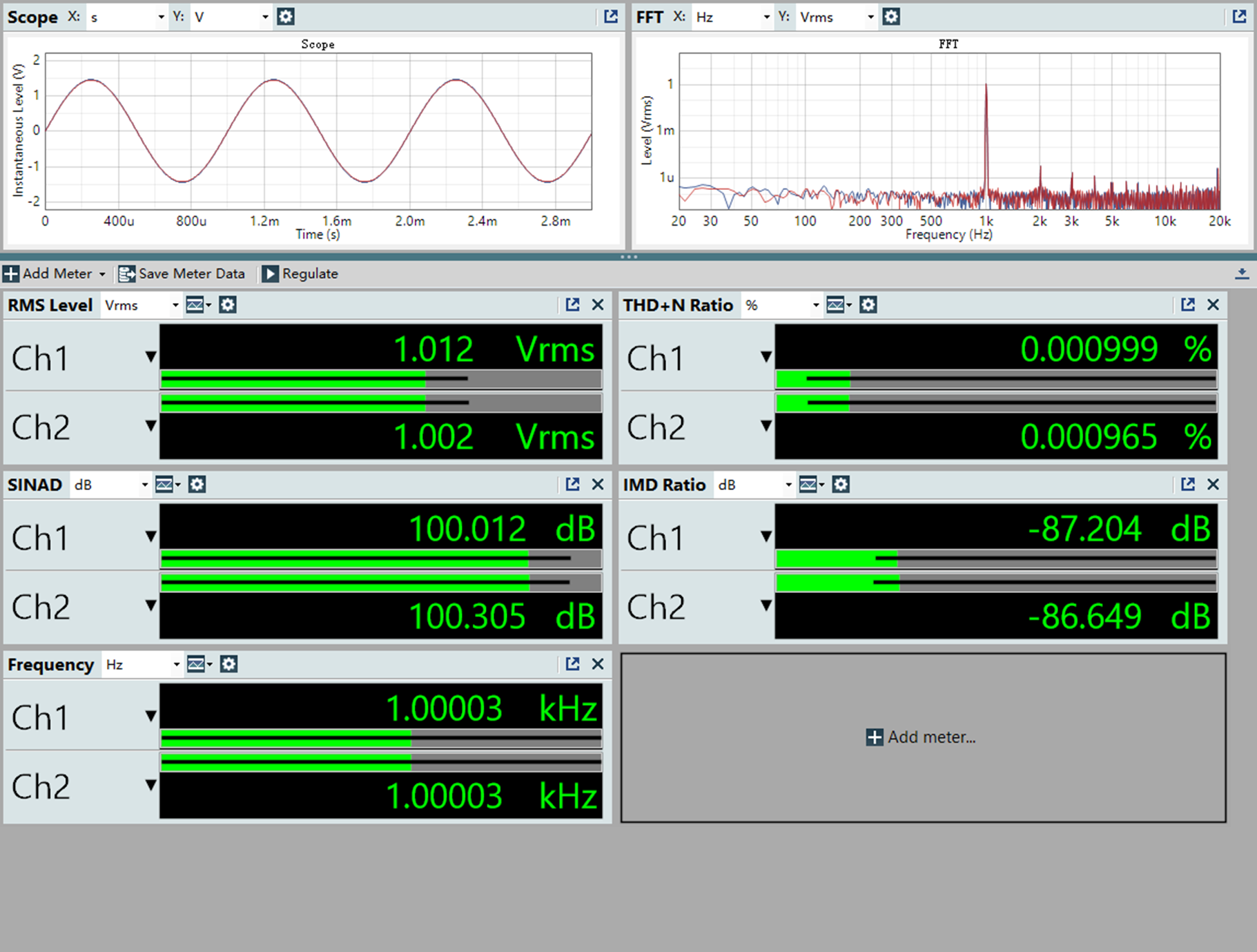

-2dB sinusoidal signal, headphone out Low gain (32Ω load)
Test conditions:
-8dB sinusoidal signal, balanced headphone out High gain (32Ω load)
