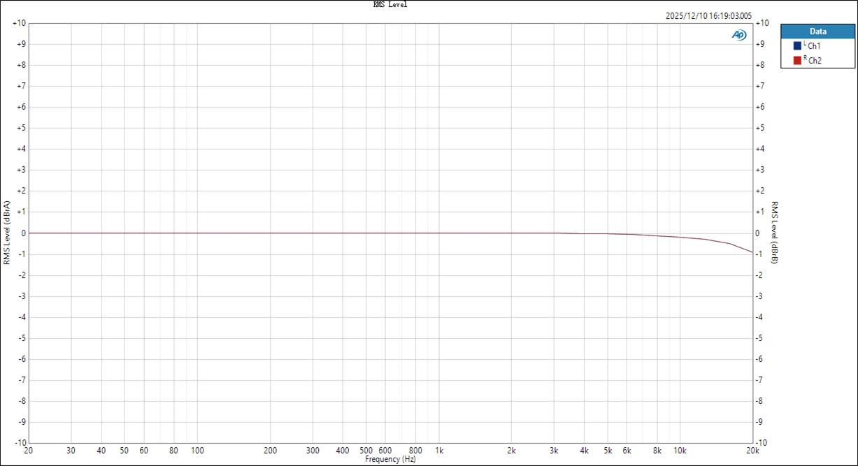

This machine, USB frequency response curve 3
Test conditions: -5dB sine signal, natural tone, big ear mode, 20Hz-20kHz,4.4mm balanced output (32Ω load)

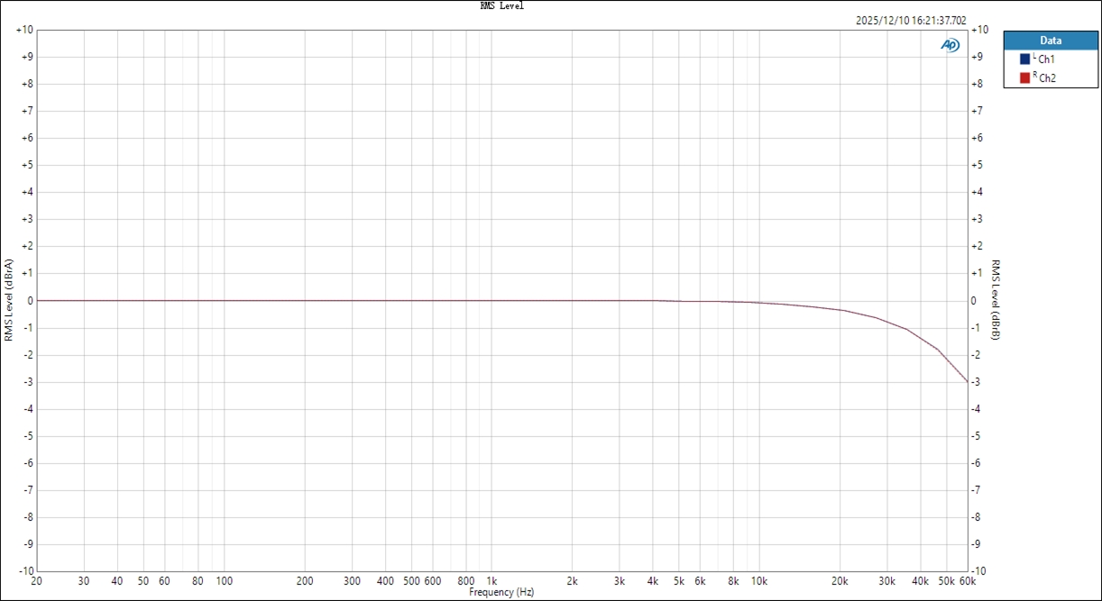

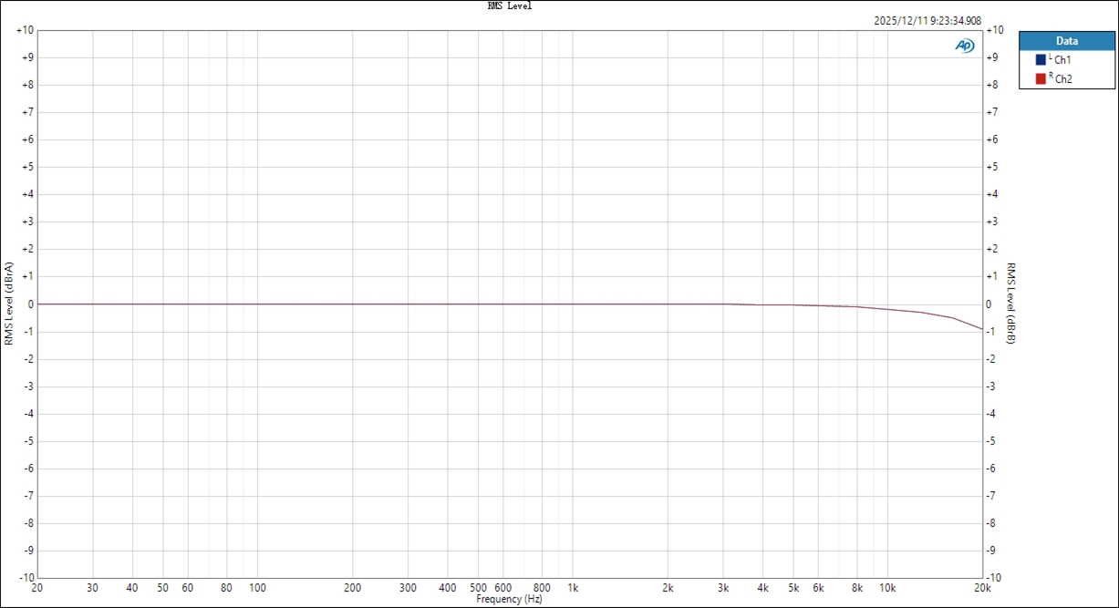

This machine, USB frequency response curve 5
Test conditions: -5dB sinusoidal signal, natural tone, 20Hz-20kHz,3.5mm line output (10kΩ load)
This machine, USB frequency response curve 6
Test conditions: -5dB sinusoidal signal, natural tone, 20Hz-60kHz,3.5mm line output (10kΩ load)
This machine, USB frequency response curve 7
Test conditions: -5dB sinusoidal signal, natural tone, 20Hz-20kHz,4.4mm balanced line output (10kΩ load)

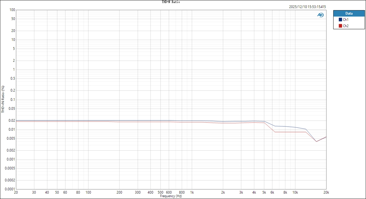

Native, USB distortion curve 1
test conditions: -6dB sinusoidal signal, natural tone, big ear mode, 3.5mm headphone output (32Ω load)

This machine, USB frequency response curve 8
Test conditions: -5dB sinusoidal signal, natural tone, 20Hz-60kHz,4.4mm balanced line output (10kΩ load)
Native, USB distortion curve 2
test conditions: -6dB sinusoidal signal, natural tone, big ear mode, 4.4mm balanced headphone output (32Ω load)
