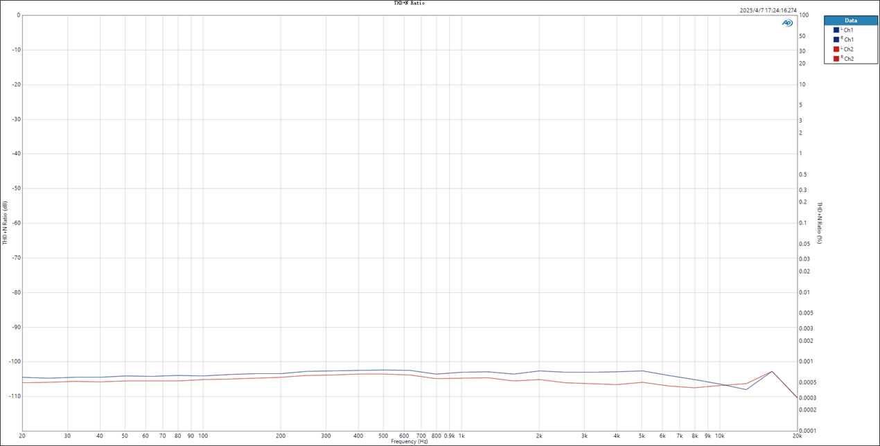

Parts of performance and parameters of PO (3.5mm, USB DAC, High Gain mode)
Output power L+R≥380mW+380mW (16Ω, THD+N<1%) Output impedance <1Ω
L+R≥290mW+290mW (32Ω, THD+N<1%) Crosstalk ≥74dB
L+R≥35mW+35mW (300Ω, THD+N<1%) Peak output voltage 9.5Vp-p
SNR ≥123dB (A-weighted) THD+N <0.0004% (1kHz/-4dB@32Ω)
Frequency response 20Hz~85kHz: attenuation<2dB Noise floor <2.1uV (A-weighted)
20Hz~20KHz: attenuation<0.02dB Dynamic range ≥123dB (A-weighted)

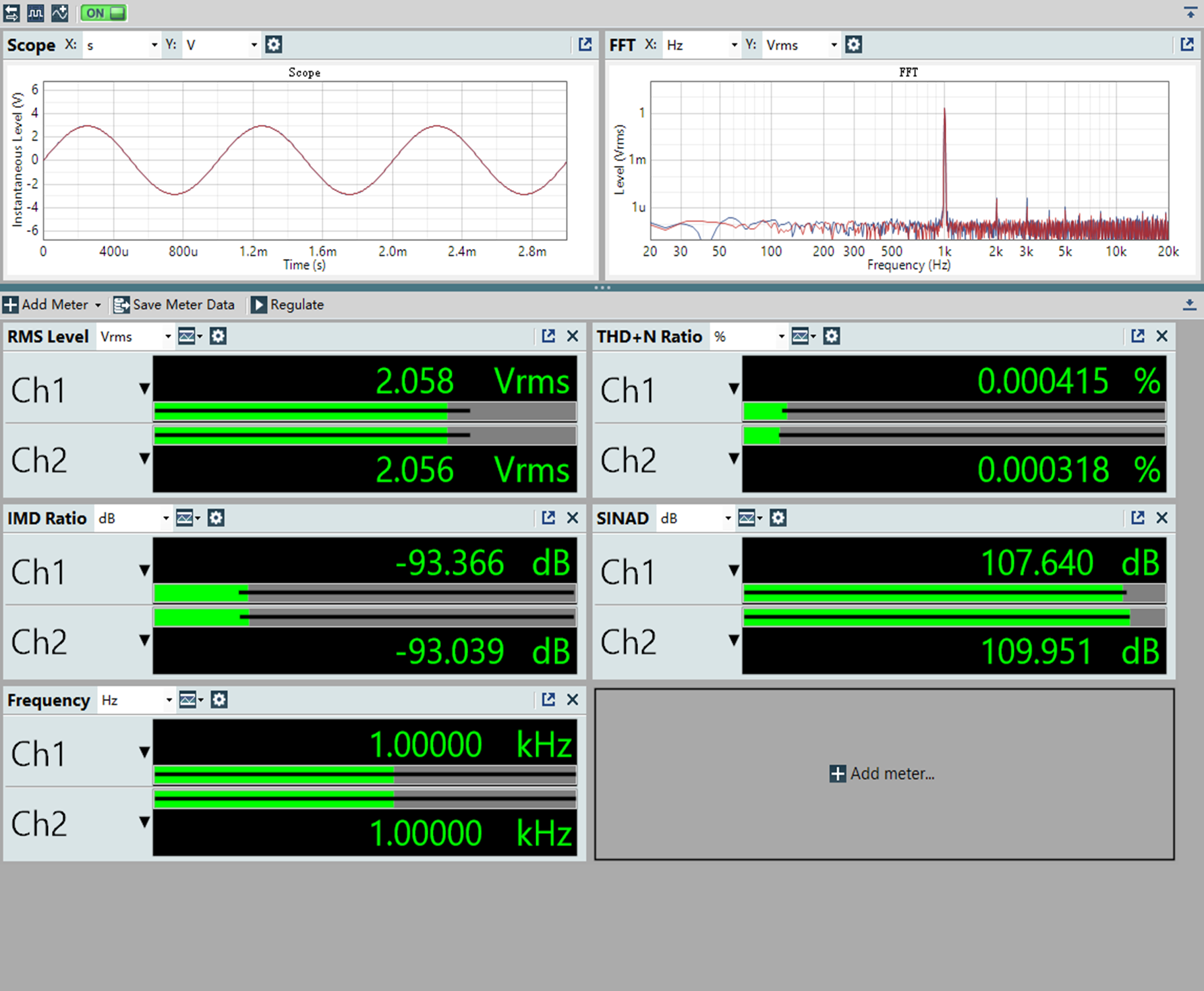

Parts of performance and parameters of LO
THD+N <0.0005% (1kHz/-5dB@10KΩ) SNR ≥122dB (A-weighted)
Crosstalk ≥111dB Noise floor <1.6uV (A-weighted)
Frequency response 20Hz~85kHz: attenuation<1.8dB Line output level 1.9Vrms
20Hz~20KHz: attenuation<0.02dB Dynamic range ≥122dB (A-weighted)

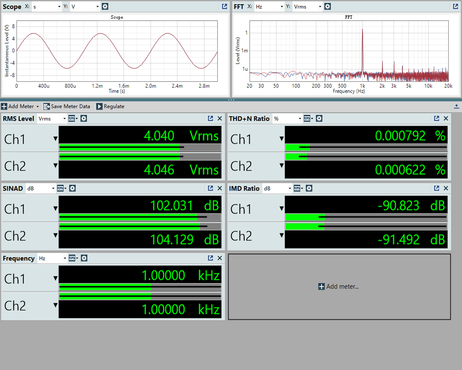

Parts of performance and parameters of BAL headphone out (4.4mm, USB DAC, High Gain mode)
Output power L+R≥600mW+600mW (16Ω, THD+N<1%) Output impedance <1.5Ω
L+R≥720mW+720mW (32Ω, THD+N<1%) Crosstalk ≥109dB
L+R≥90mW+90mW (300Ω, THD+N<1%) Peak output voltage 15Vp-p
SNR ≥125dB (A-weighted) THD+N <0.0005% (1kHz/-8dB@32Ω)
Frequency response 20Hz~85kHz: attenuation<2dB Noise floor <2.7uV (A-weighted)
20Hz~20KHz: attenuation<0.03dB Dynamic range ≥124dB (A-weighted)

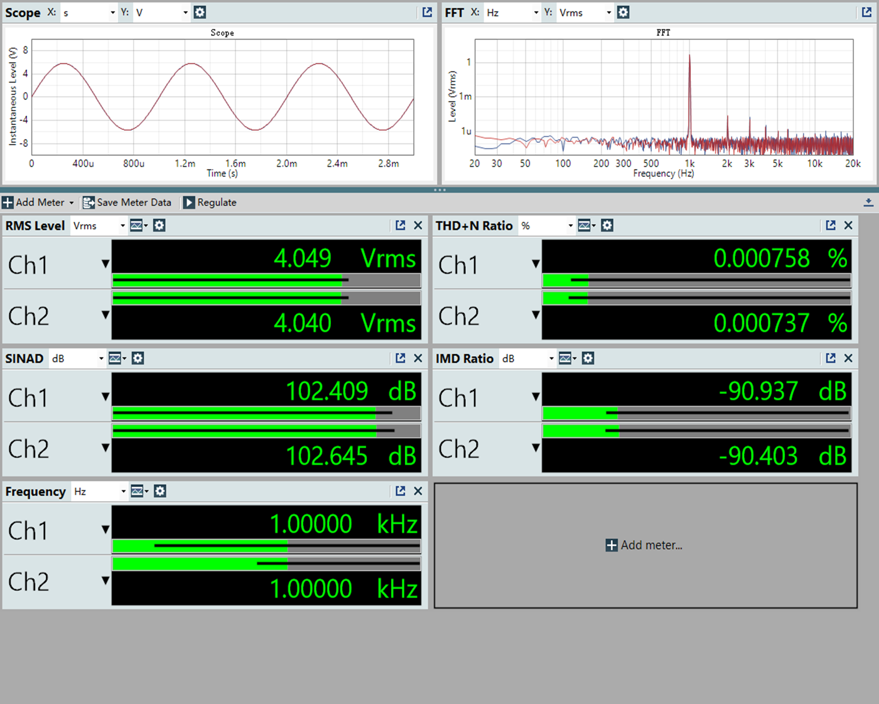

Parts of performance and parameters of BAL LO
THD+N <0.0003% (1kHz/-0dB@10KΩ) SNR ≥126dB (A-weighted)
Crosstalk ≥103dB Noise floor <1.9uV (A-weighted)
Frequency response 20Hz~85kHz: attenuation<1.8dB Line output level 3.9Vrms
20Hz~20KHz: attenuation<0.02dB Dynamic range ≥125dB (A-weighted)

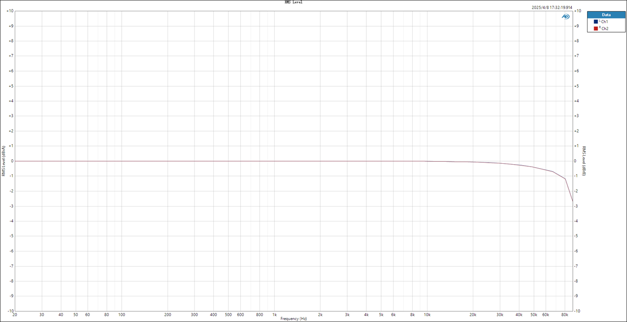

UAC Decoding Frequency Response Curve 1
Test conditions: -5dB sinusoidal signal, 20Hz-85kHz, line-out (10kΩ load)

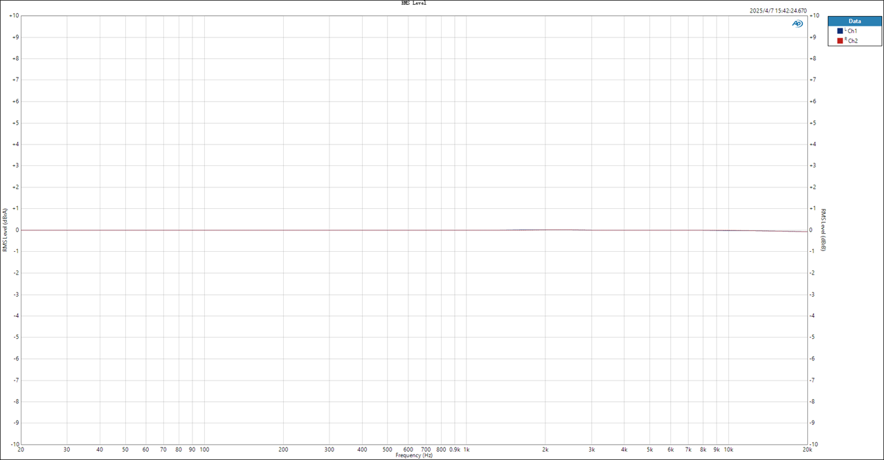

UAC Decoding Frequency Response Curve 4
Test conditions: -5dB sinusoidal signal, 20Hz-20kHz, line-out (10kΩ load)
