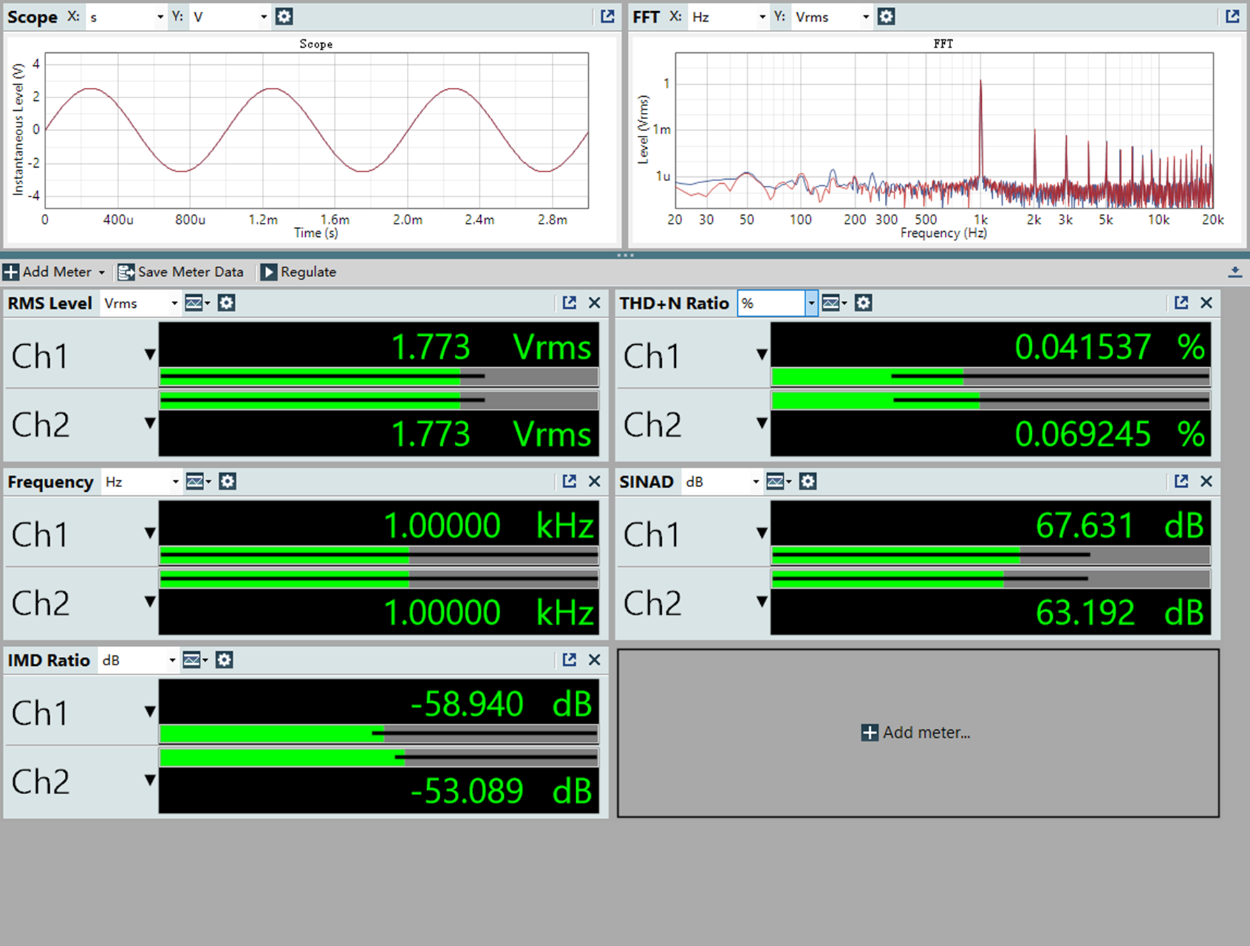

THD+N About 0.052% (1kHz/-7dB@10KΩ) SNR ≥112dB (A-weighted)
Crosstalk ≥96dB Noise floor <4.5uV (A-weighted)

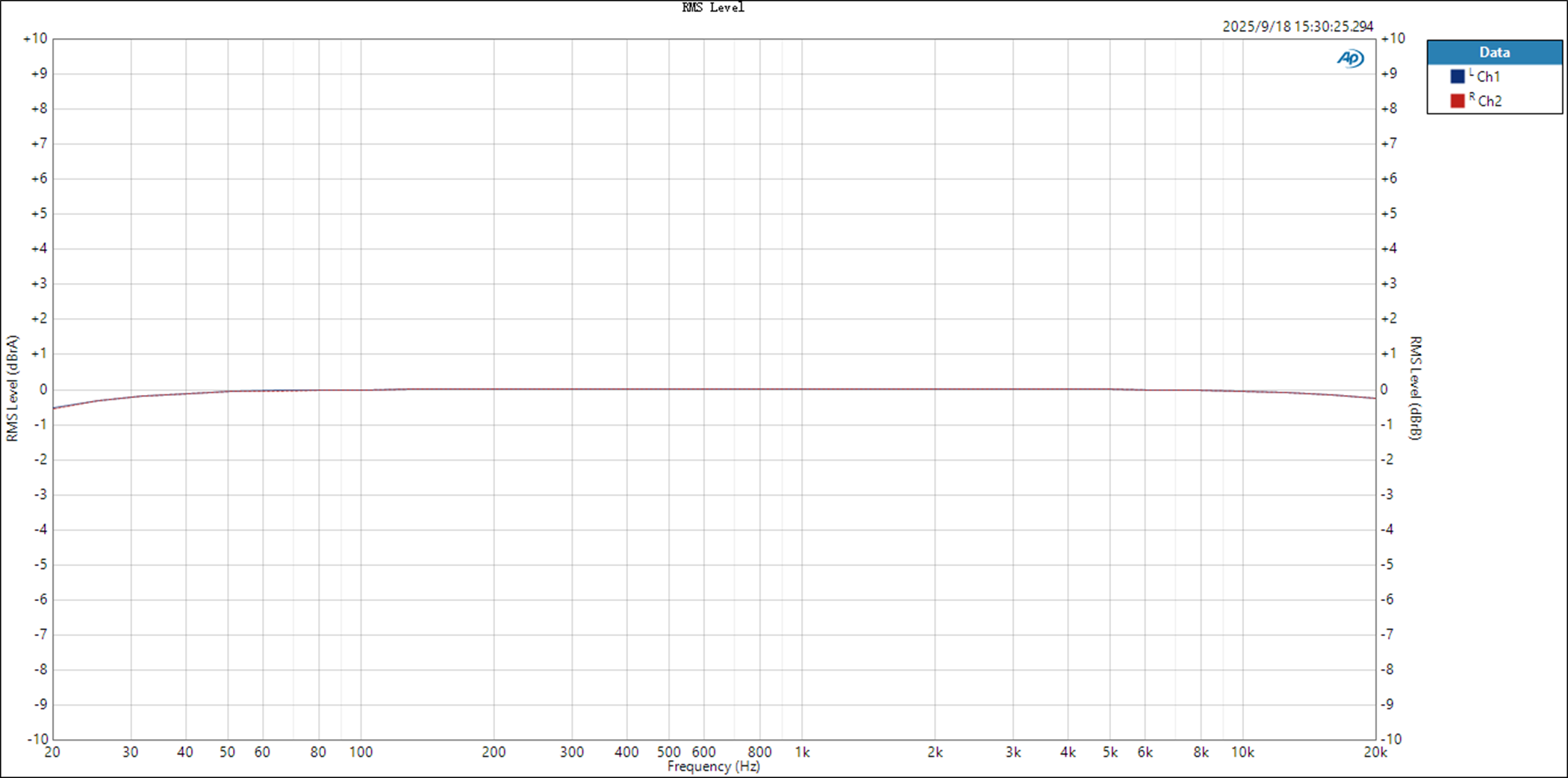

Test conditions: -5dB sinusoidal signal, 20Hz-20kHz,
RCA line output (10kΩ load)

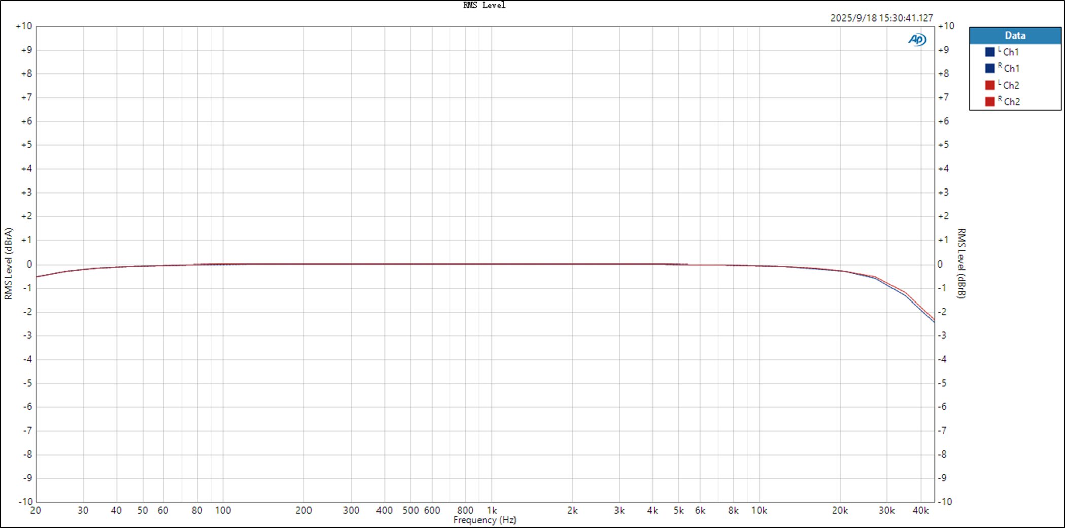

Test conditions: -5dB sinusoidal signal, 20Hz-80kHz, RCA line output (10kΩ load)

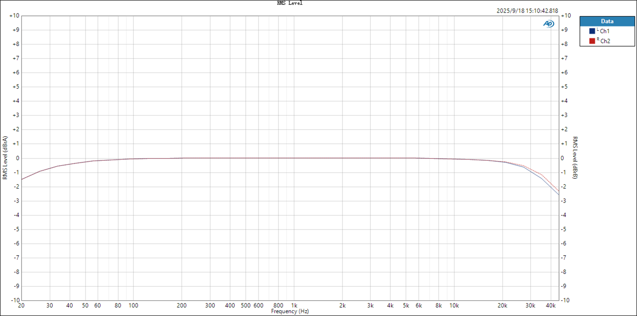

Test conditions: -5dB sinusoidal signal, 20Hz-20kHz, XLR3 balanced line output (10kΩ load)

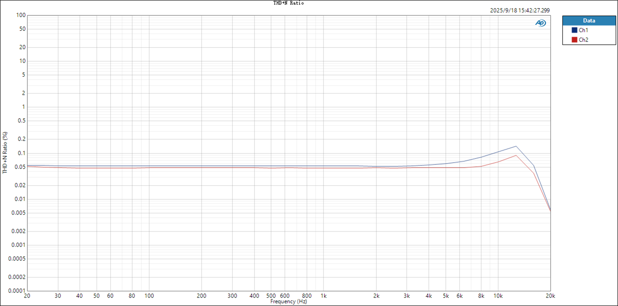

Test conditions: -7dB sinusoidal signal, RCA line output (10kΩ load)
