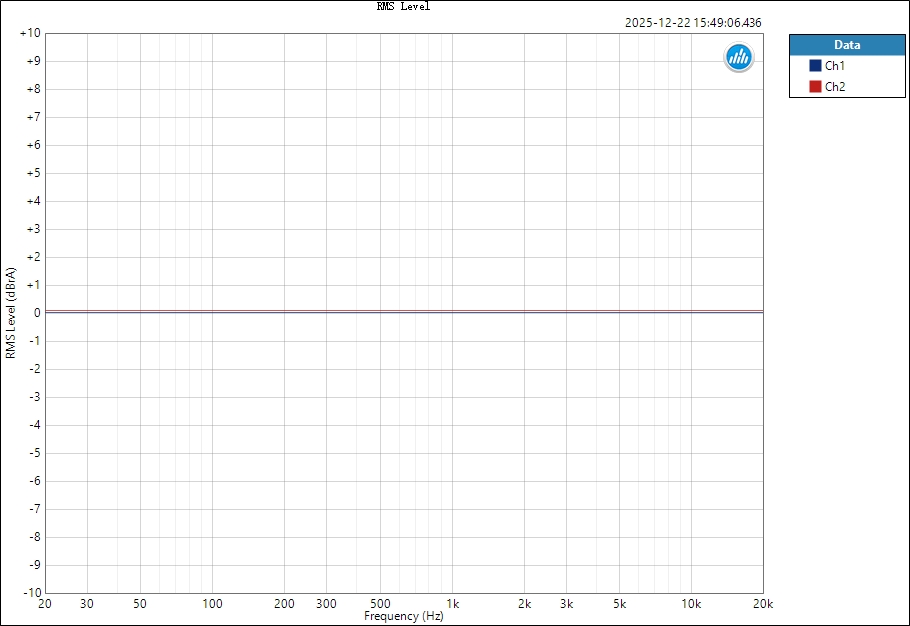

Frequency response curve 1
Test conditions: Local playback, -5dB sinusoidal signal, 20Hz–20kHz headphone out (32Ω load)
Blue: Left channel Red: Right channel

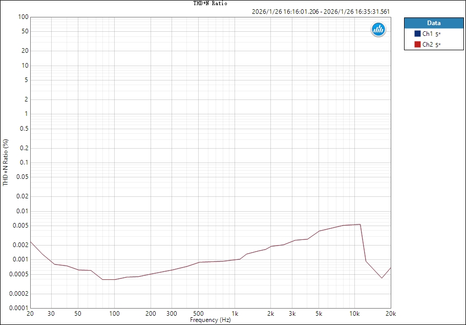

Frequency response curve 2
Test conditions: Local playback, -5dB sinusoidal signal, 20Hz–20kHz balanced headphone out (32Ω load)

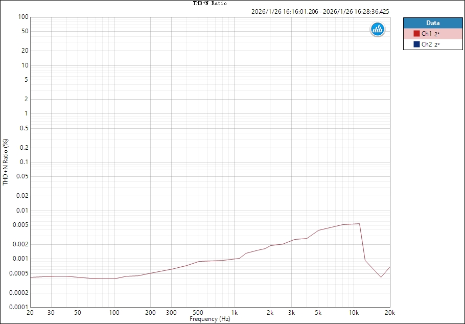

THD+N Curve 2
THD+N Curve 1
