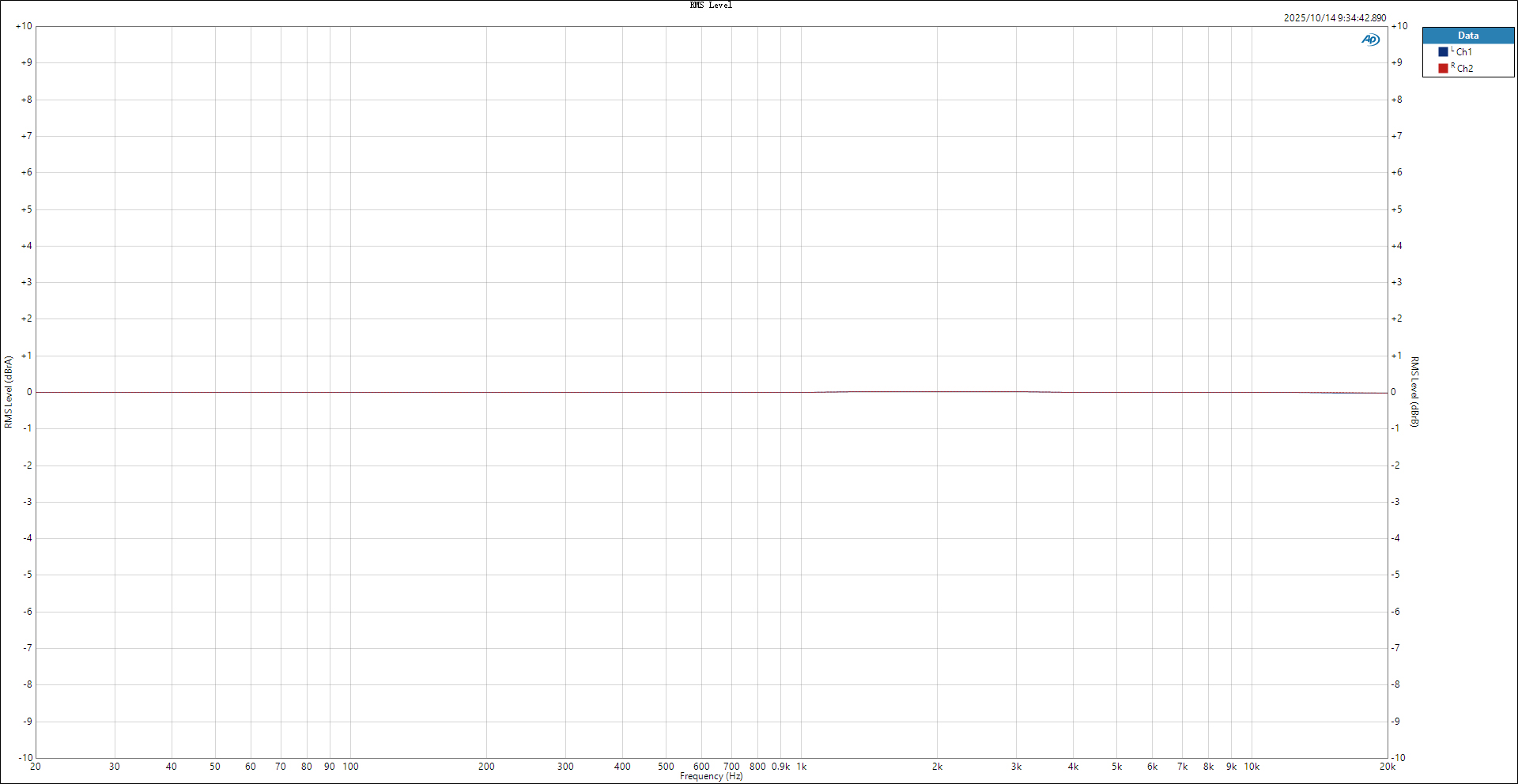

This machine, USB, coaxial frequency response curve 1
test conditions: -5dB sine signal, super big ear mode, 20Hz-20kHz,4.4mm balanced output (32Ω load)

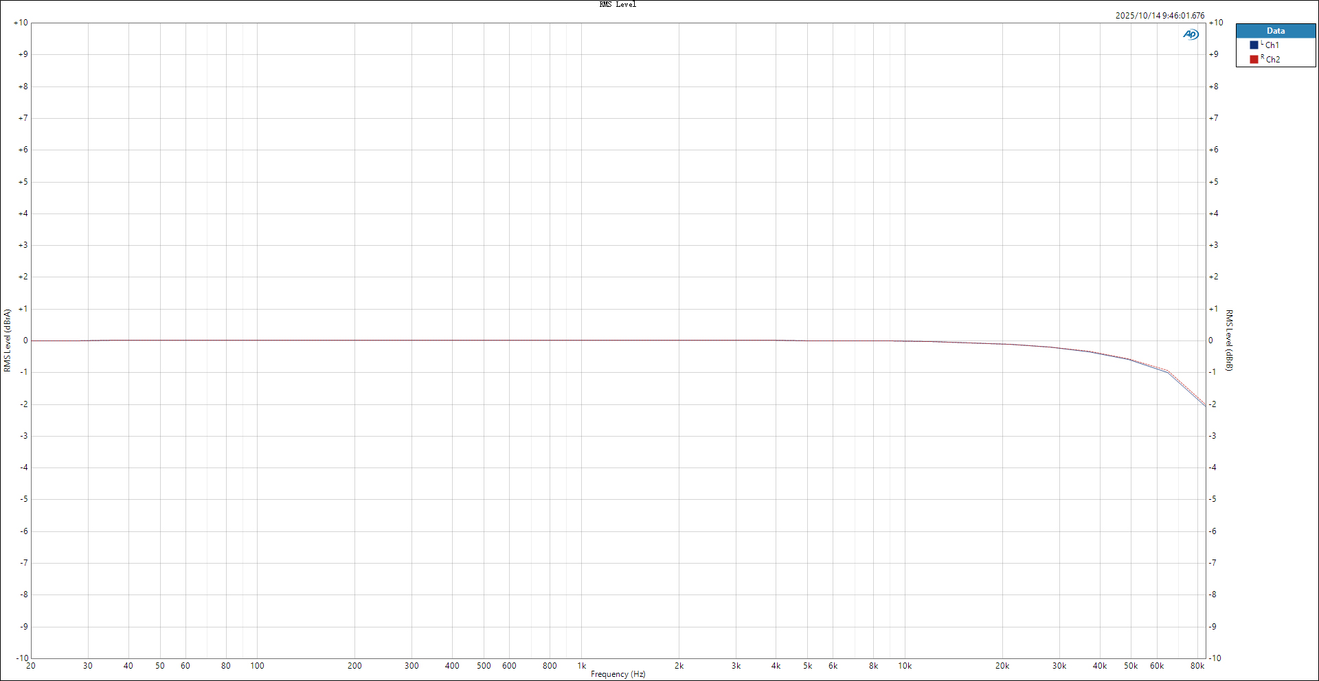

This machine, USB, coaxial frequency response curve 2
test conditions: -5dB sine signal, super big ear mode, 20Hz-85kHz,4.4mm balanced output (32Ω load)

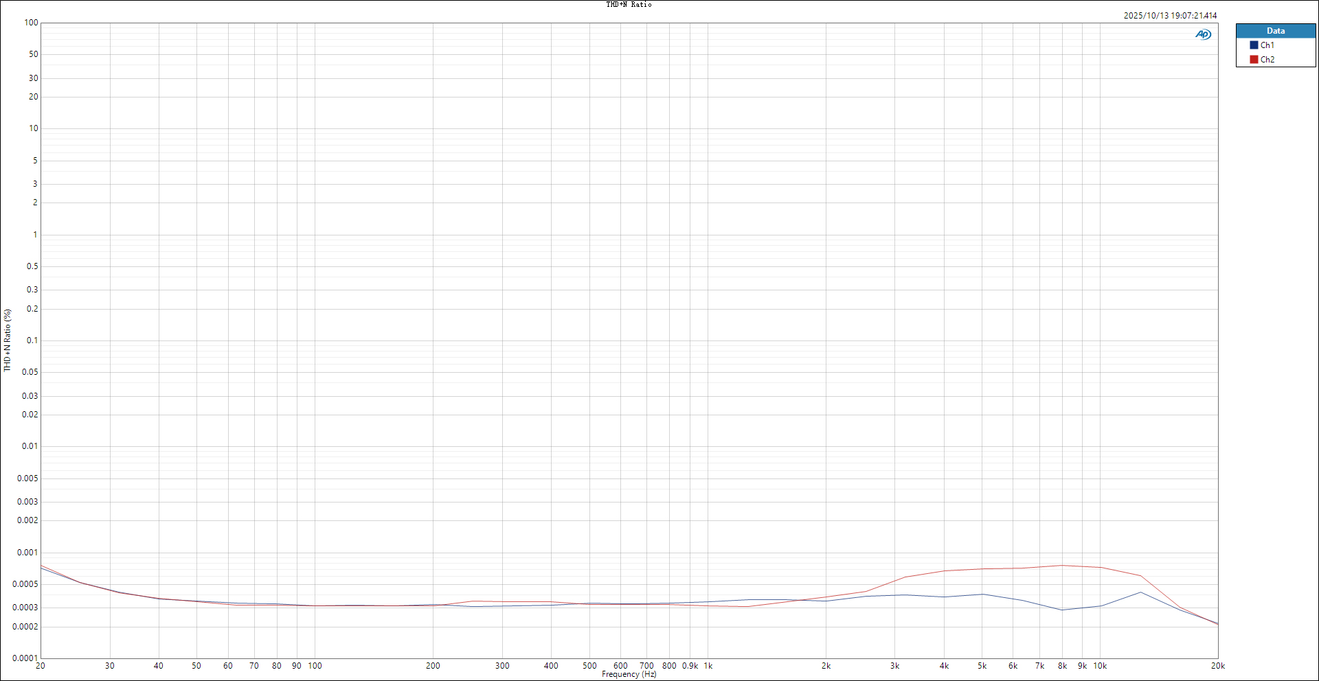

Local, USB, coaxial distortion curve 1
test conditions: -6dB sinusoidal signal, super big ear mode, 4.4mm balanced headphone output (32Ω load)

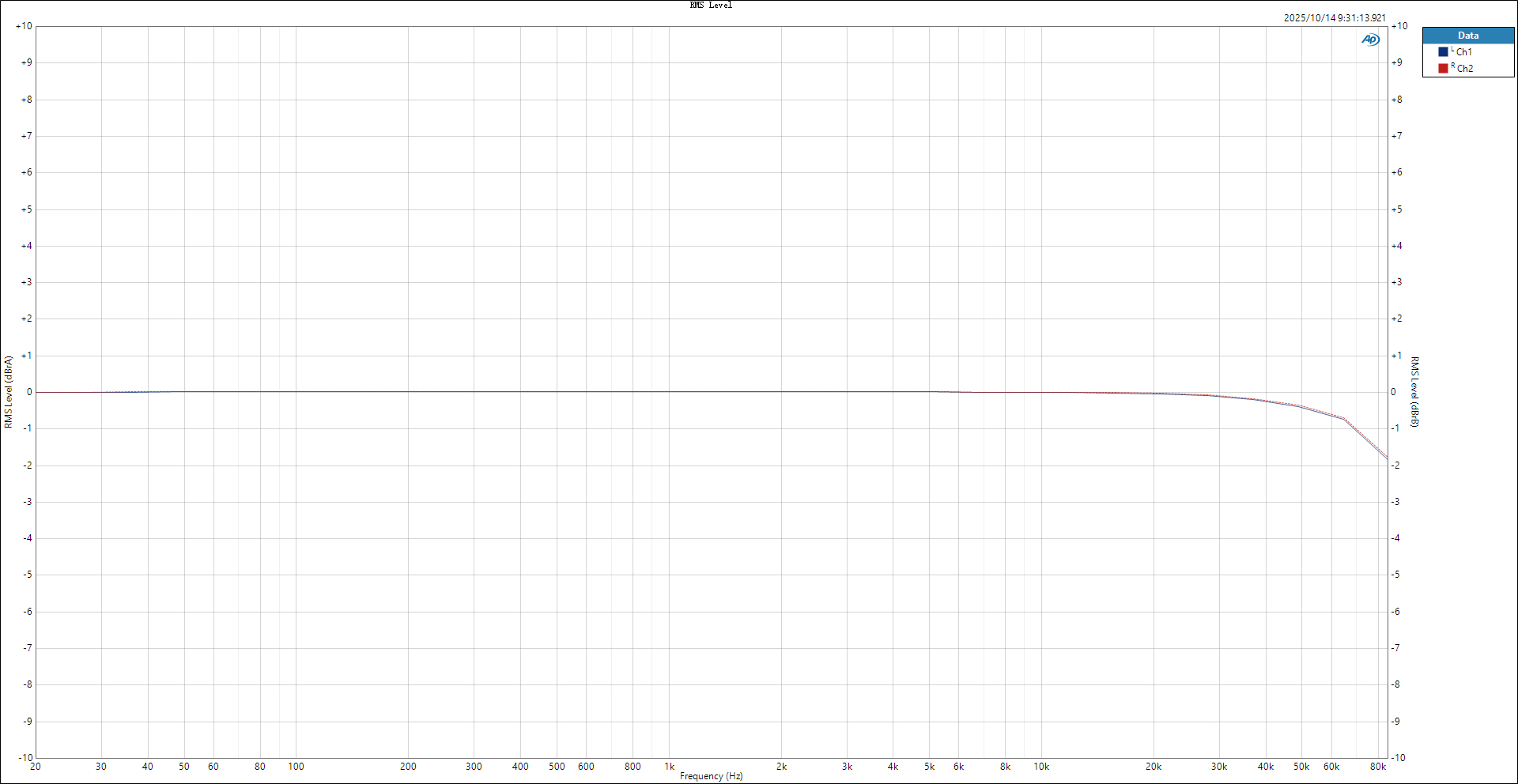

This machine, USB, coaxial frequency response curve 4
test conditions: -5dB sinusoidal signal, big ear mode, 20Hz-85kHz,4.4mm balanced output (32Ω load)

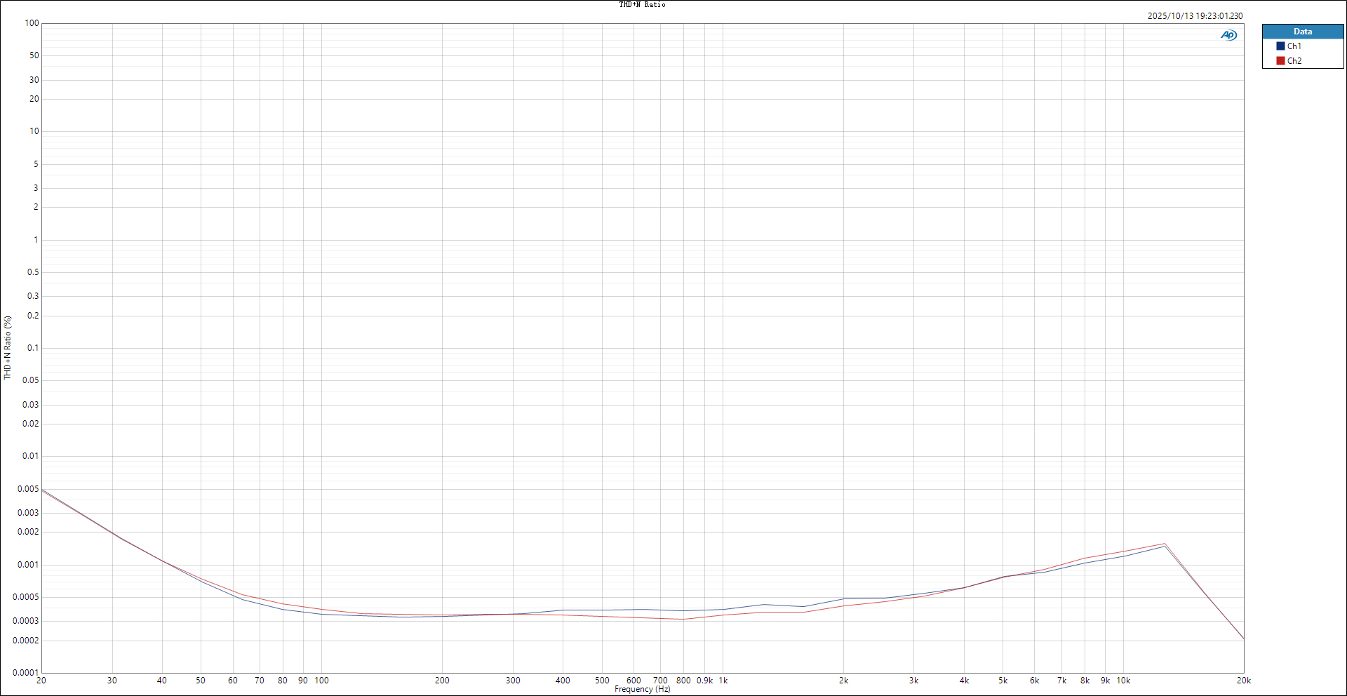

Local, USB, coaxial distortion curve 2
test conditions: -6dB sinusoidal signal, big ear mode, 4.4mm balanced headphone output (32Ω load)

Output power 2 L+R≥285mW+285mW(32Ω,THD+N<1%,3.0Vrms) channel separation ≥ 110dB (1kHz @ 32Ω)
Output power 3 L+R≥30mW+30mW(300Ω ,THD+N<1%,3.1Vrms) distortion plus noise 0.00043%(1kHz/-3dB @ 32Ω)
bottom noise <4.8 μV(A-weighted) signal-to-noise ratio ≥ 116dB (A-weighted)
frequency response 20Hz ~ 20kHz: attenuation <0.1dB dynamic range ≥ 113dB
20Hz ~ 85kHz: Attenuation <2dB peak output voltage >8.6Vp-p
Balanced line output part performance parameters (4.4mm output, local playback/USB DAC/coaxial decoding)
distortion plus noise 0.00027%(1kHz/-5dB @ 32Ω) signal-to-noise ratio ≥ 127dB (A-weighted)
channel separation ≥ 107dB bottom noise <1.9uV(A weight)
frequency response 20Hz ~ 20kHz: attenuation <0.2dB dynamic range ≥ 123dB
20Hz ~ 85kHz: Attenuation <2.1dB Line Output Level 4.2Vrms (1kHz@10kΩ)
